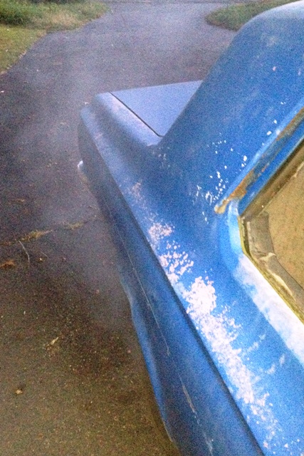

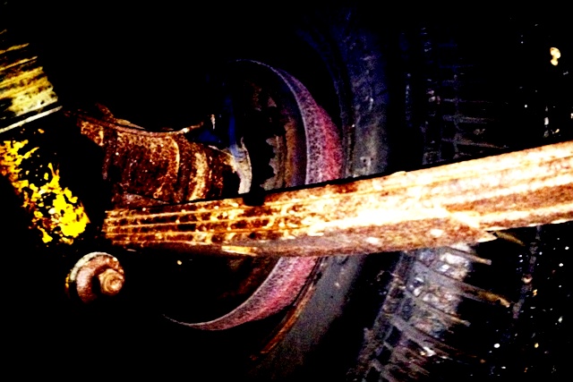

OK, so I stopped for gas and noticed a whole lot of smoke coming from the wheel wells in back. I had just driven about 50 miles of interstate. It wasn't on fire so I figured, may as well finish the last 10 miles home. I get home and there is more smoke (not as much as before) but when I look under the car I see something glowing red behind the passenger rear wheel. The brake drum! DOH!
I guess I will be doing that brake job sooner than later....

I suspect that your axle seals on that side are now roasted and useless.
That WAS one really good set of brakes to get the drum glowing.....never have seen it that bad.... congrats, I think you set a new record! Whew....

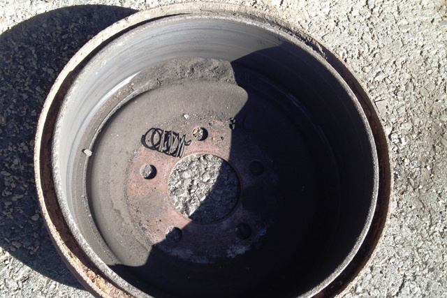

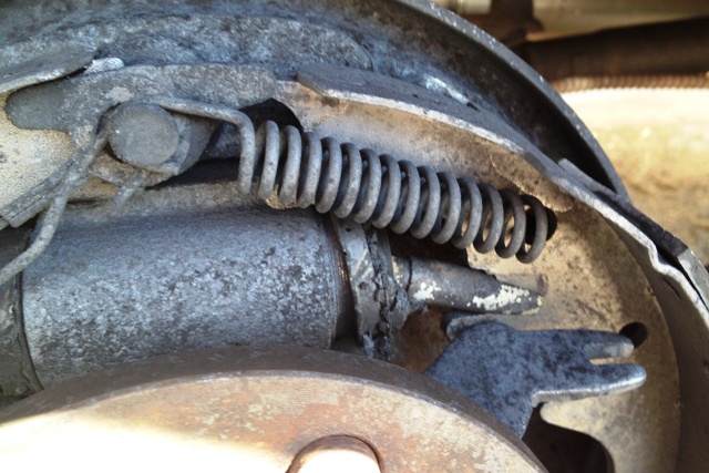

Good news, rear brakes are already 2 1/2. For some reason, I thought they were only 2 inch.
Bad news, everything is toast...literally!
Not really certain what happened. E-brake spreader bar spring just fell out, everything rubber is burnt/melted. All springs lost tension, to the point I took them off with my bare hands.
Mama Mia! Time for new everything, including new finned drums.
Good times...

Wow, that looks rough. Make sure to replace the rubber line as well. I have had them swell shut and keep the brakes engaged resulting in problems you just experienced.....minus the glowing red drum:)
You might as well go for a disc brake upgrade.
I don't have any plans for rear disks anytime soon. It is a street/bracket car and if anything, I'll go with bigger front rotors and larger rear drums. Most of my money will go into the motor and trans first.
Yup, and sometimes they break apart inside and jam the fluid in a cylinder/caliper; had a front rotor on a towed car jam up due to an old line that almost got this bad....but the smoke from the grease melting clued me in just in time... So agreed, if the rubber lines are old, it is time to replace them all, rear and front. They don't cost much at all on these cars. In this case, such a failure in the rubber line to the axle should have jammed both rear brakes however so perhaps not in this instance.
Only thing original on the car is the from rear rubber line all the way to the wheel cylinders. Each wheel has original parts except for the shoes. I replaced everything else with new parts when I upgraded to front disk brakes. At this point, I will be replacing everything from the rubber line back.
