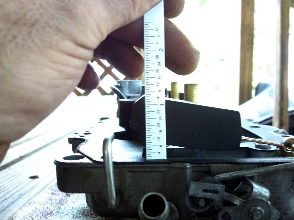

ok folks, besides all this 2bbl/4bbl/heads/cams/etc crap :grin:....I think i found my problem, i got the top of the carb off, and the pump plunger looks to be in new condition, along with the rest of the carb internals..I do think the float settings are totally off..They are both set at almost an inch and a 1/4 height...I'm getting between 27/32nds and 29/32nds for the stock settings in google search...
Can someone verify the settings...thanks :)
here's what i have...

fixed it :grin:
I set the floats at 29/32nds, and she eats good now :D
