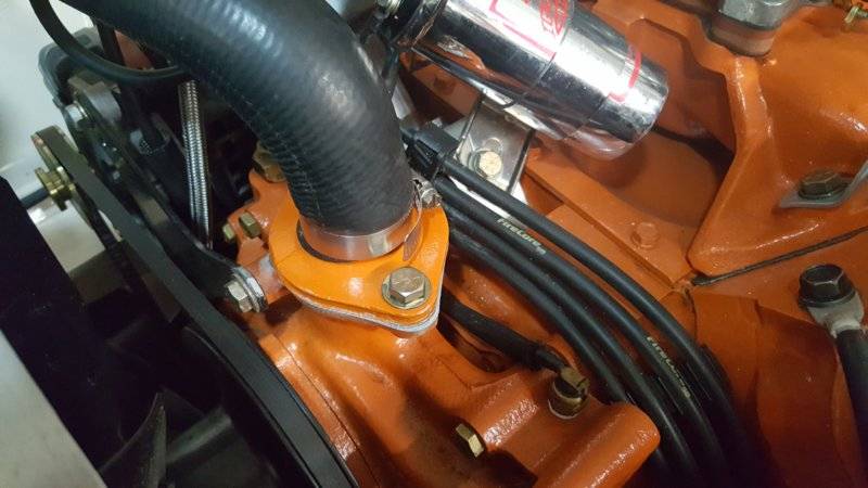

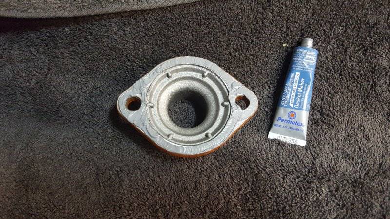

Member @Cranky came to the rescue and gave up one of his OE housings to a worthy cause

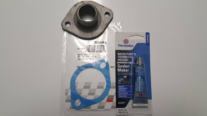

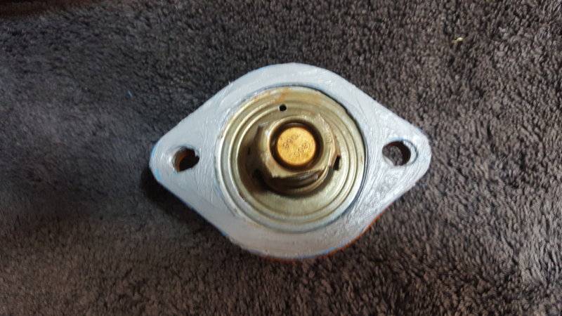

@texas69bee I tried the Permatex for water pumps and t-stat housings.

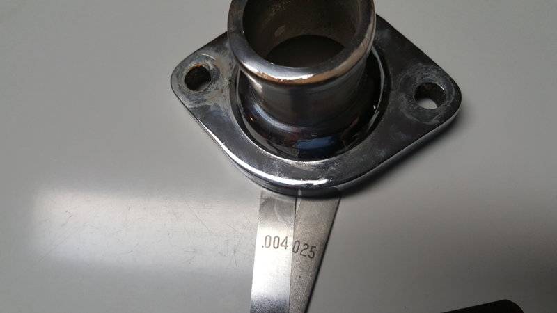

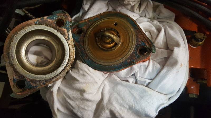

You can see that I had used the Fel-Pro gasket. The cast aluminium, chrome housing had warped .030

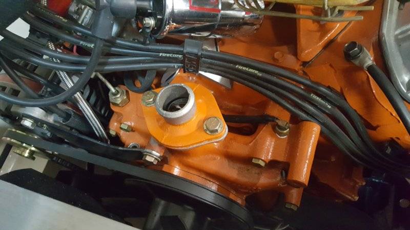

Following the directions, it reminded me of the black gasket maker that I used on my aluminium valve covers. Apply sealant, install finger tight, let it set up for an hour then torque to specs. Let it cure for 24 hrs. before allowing fluid contact.
