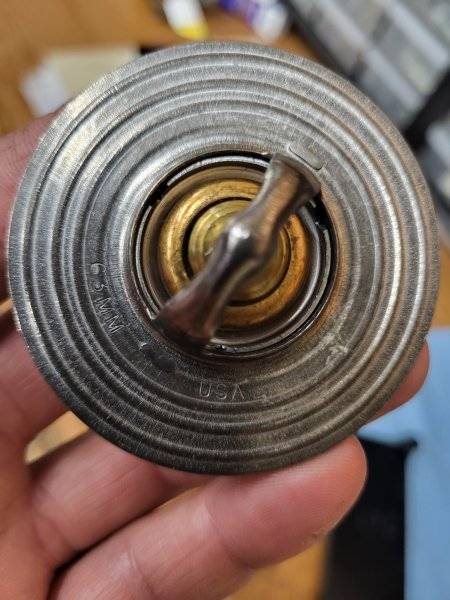

Thermostat part number needed
I'm not seeing any notches on mine.

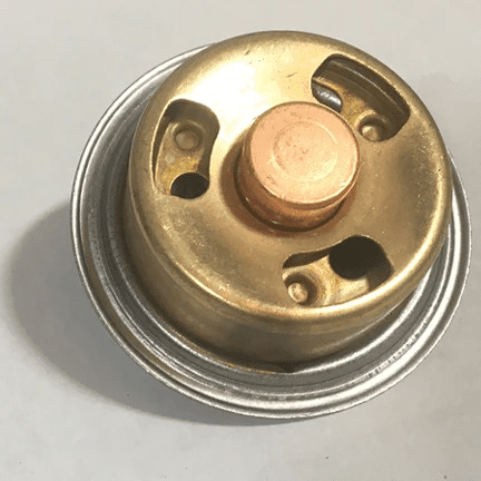

IMO.....The "BEST" thermostat to use is the Robertshaw design
Why Robertshaw? Because we make a hi flow pump and its unique three port construction or "balanced sleeve" design equalizes the system pressures above and below the thermostat’s moving valve. Therefore the thermostat is pressure balanced and will respond to system temperatures only. No other thermostat does this.
Other Features of a Robert Shaw Thermostat:
1) Stress-free construction. Robertshaw makes the thermostat's strut assembly from brass, not stainless steel, because brass can be bradded to the housing with heat instead of sledge hammer-like stress. This technique permits two brads per strut. Other manufacturers forcefully attach the struts to the housing with intense, metal-weakening pressure on the struts, binding each strut in only one spot.
2) The Power Pill®. This is the heart of a Robertshaw thermostat. It detects minute changes in the temperature of the coolant, and quickly activates a precision-engineered stem or piston to open and close the thermostat valve.
3) One-piece bypass poppet. With other thermostats, the bypass valve stem is welded on. The weld tends to fail under stress. To eliminate this problem, Robertshaw manufactures the entire copper cup and bypass stem from a single piece of metal.
4) Short-stroke piston. In conventional thermostats, the piston must make a large stroke to open the thermostat far enough for adequate coolant flow. But the long stroke compromises durability. Robertshaw engineers achieved a shorter stroke with a uniquely-designed flange and poppet. This design increases the longevity of the thermostat, yet still allows adequate coolant circulation.
5) Contoured strut. Making the strut assembly from brass instead of steel provides another benefit: brass, being more malleable than steel, can be precisely formed to maximize coolant flow.
6) Uniform quality. Robertshaw builds all thermostats to OEM standards -- so your replacement thermostat is identical to those used in new Fords, Chryslers, and other cars.
Ive used this same 180° F T-stat for years.....with great success. Consider trying it......

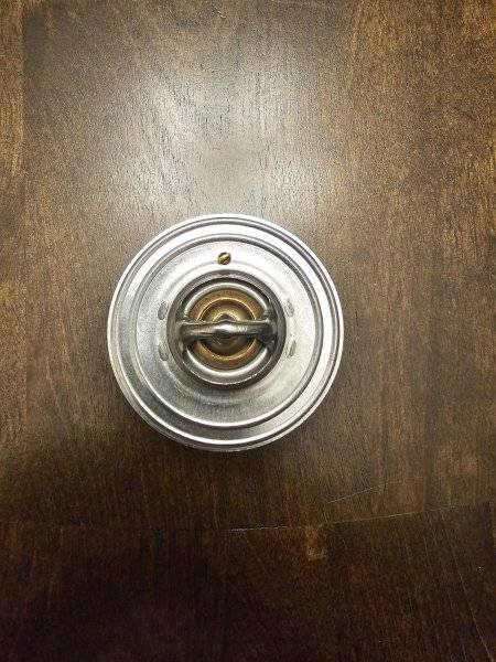

My car runs at constant ~ 180°F with the new Edelbrock 8607 180°F Thermostat @ 86°F outside temperature.
I'm happy with that. :)

Last year (as stated in my last post) i installed an Edelbrock 8607 180°F Thermostat.
As stated in my last post "My car runs at constant ~ 180°F @ 86°F outside temperature."
Except for when i drive faster -> 80, 90mph+ Than the temperature starts climbing higher than it should.
Since its a bone stock 1969 dodge charger r/t 440/727 car and it runs great i do not really think it needs carb or timing adjustment.
Also i flushed the block with water when replacing the water pump and it did not look rusted etc.
I plan on test running it without a thermostat and see what that does. Should this fix my issue i would be interested in trying out one of these Robertshaw ones. Which one would be the correct one for my car? There is a original mopar sticker in the engine bay stating only use 180°F Thermostat so that much i already know.

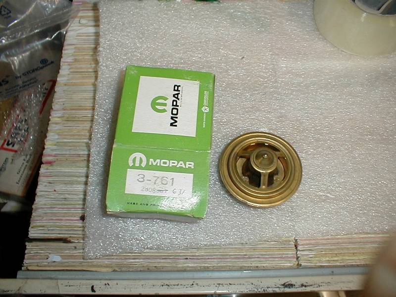

One more thing is i actually have an NOS 180°F mopar thermostat and this indeed looks like a Robertshaw Thermostat.
The Edelbrock IS way more restricted in flow so that's why i think that it really could be the problem under load...

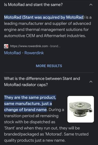

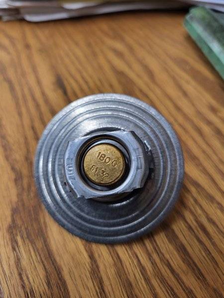

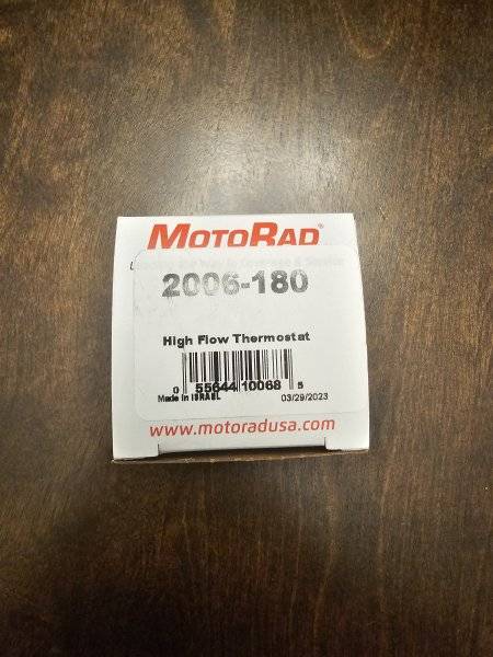

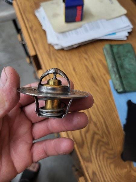

Stant 370-180 works! Always test your thermostat before installing! I found mine on eBay.

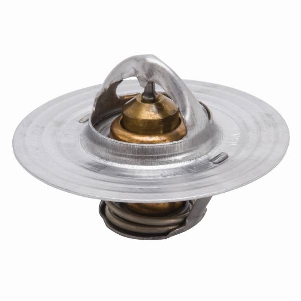

Not the same as the T-stat shown on #23 pix, which is the balanced flow design. What you show looks like a copy of the old Dole design. I'm reasonably sure it will function, but its not the balanced flow design......JUST my opinion of course...
BOB RENTON
Not the same as the T-stat shown on #23 pix, which is the balanced flow design. What you show looks like a copy of the old Dole design. I'm reasonably sure it will gunction, but its not the balanced flow design......JUST my opinion of course...
BOB RENTON

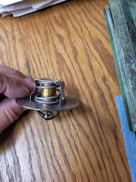

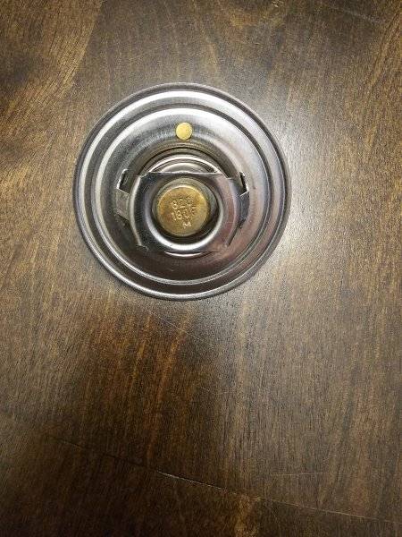

Yes, I see the differences from post 23 but this is a substitute or the SuperStat on post 14. It is made by the same/new company, it looks very similar, and it has the same specs and is rated for high flow. An added bonus is that it comes from a country with indoor plumbing and quality standards!
if you measure the actual opening, the balanced flow type has a significantly larger opening. The Stant is 1 1/8", the Mopar 68 and earlier, like post #33, is about 1 7/16" Flow increases by the square of the diameter EMP/Stewart is another brand available at Summit. Bob has good information in his posts. The amount of flow should be increased if the motor is "hotter" than stock.
May not be the right part # in the link, but they have them.
