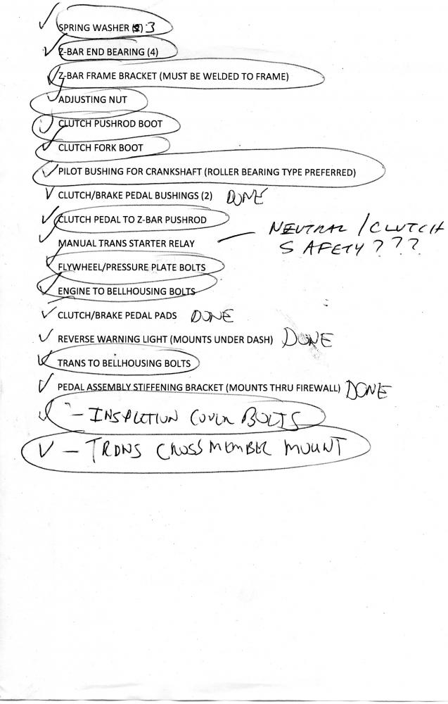

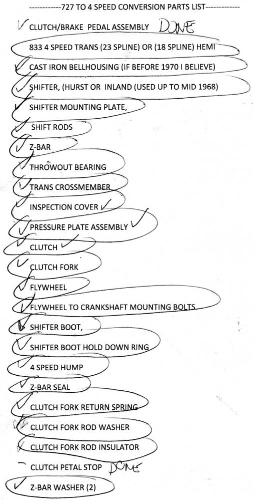

I swapped my auto trans for a 4 speed in my '68 Charger. Instead of buying a kit, I slowly purchased the parts over the last 2 years. It is less expensive . I used Ebay, Craigs list and other sources for parts. It is not that difficult, I have a list of parts I used if you are interested.

Here is another thought, I know Passon Performance was working on an overdrive trans. Not sure of how much is needed to install it. It depends on how you are going to be driving your car, but with mine I went with the standard 833 trans from an auto. The only cutting was in the trans hump so the shifter and shifter rods would clear. No other cutting was needed. Just a change in the trans cross member mount, no need to change the drive shaft or yokes etc. It is pretty straight forward. I did not want to hack up my car, so I went this route. I have my trans and all the parts, so somebody could convert it back.
I could use the parts list, my car came from factory with 4 speed , at some time ,money permitting I would like to change it back so I can curse with better braking, and make more orginal.
Parts list
Here is the list of parts for converting from a 727 auto to a 4 speed. Eventhough you have a Coronet, my Charger has the same drive train.
