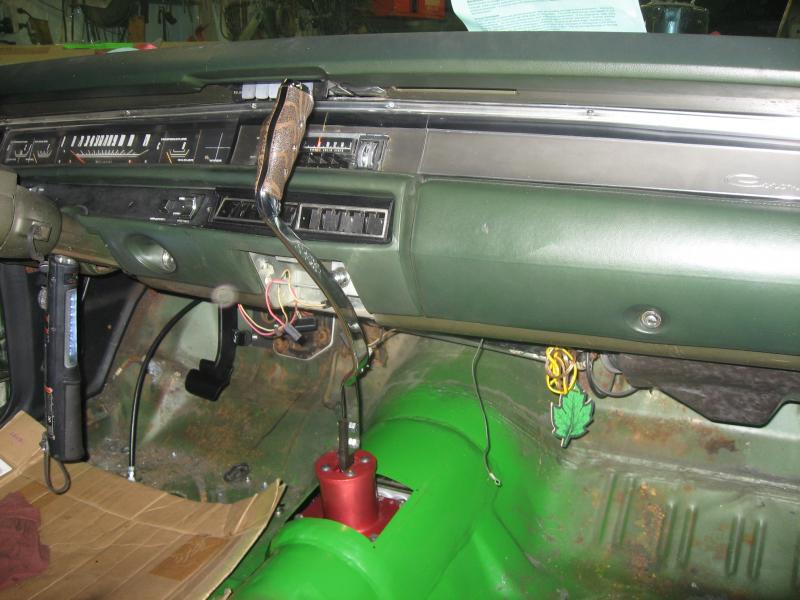

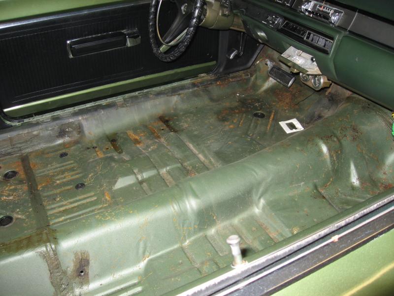

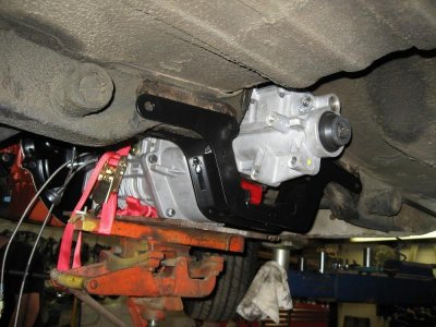

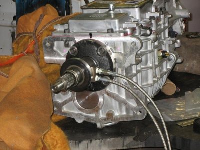

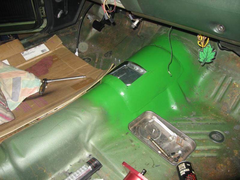

this might help. its for the tko 5 spd. was originally going to go 4 spd so we cut for that to put in 4spd hump but changed to 5 spd. just cut 1 hole in center, thats all.
1- stock floor
2- we had cut already for 4spd hump add on then went 5spd. fabed new pc with 1" rise for fit.
3- finished look
4- tranny with hyd clutch throw out ready for install
5- front finished view
6- rear finished view
7- test fitting pic
hope it helps. rick

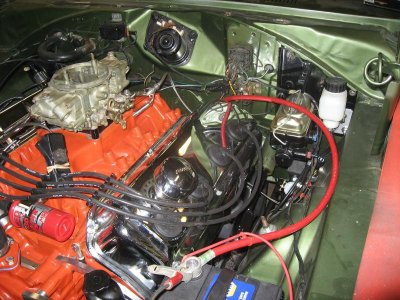

Hey Shag766, I noticed the your T/O has 2 lines running to it. Is that their new setup? Do you have a pic of the master?

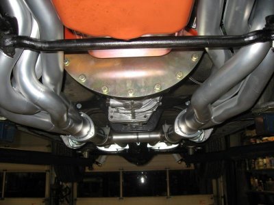

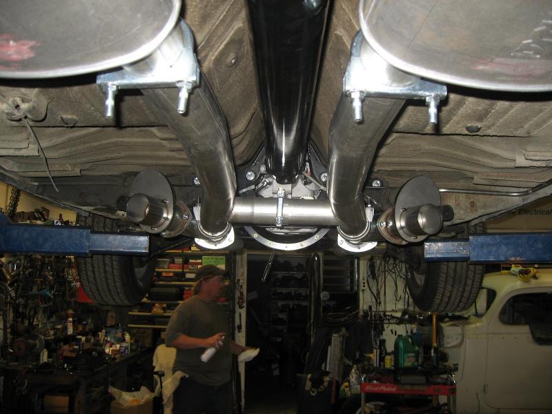

thanks Rick, nice looking set up. would like to hear how those exhaust cutouts work and who they are from/what they are called or part number.

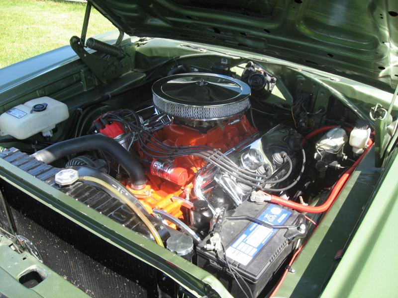

here is the only pic's i have right now. the 1st one was shortly after the install of the motor, loose wiring. 2nd one is wiring cleaned up. in the 1st pic the little white plastic bottle is the reservoir for the clutch and right under the brake booster you can see the top of the slave. sorry. i remember we had a hell of a time getting the air out of the system.
they are made by doug's. jegs has them. they work really well. i am buying another set in the spring for another car that i put a set of pypes on and they are junk. the pypes style is a butter fly in the center of the pipe and you can't stop them from leaking, believe me i have tried. i call the dougs type a guillotine system and the block off plate runs in tracks. the other system depends on the motor to hold it closed.
