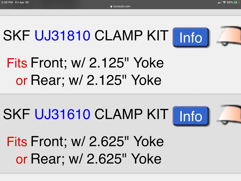

The straps are different sizes. The bolt spacing and the curve for the cap. You will need other ones for the big yoke. Here is a rockauto page. $3.29 and $8.87
