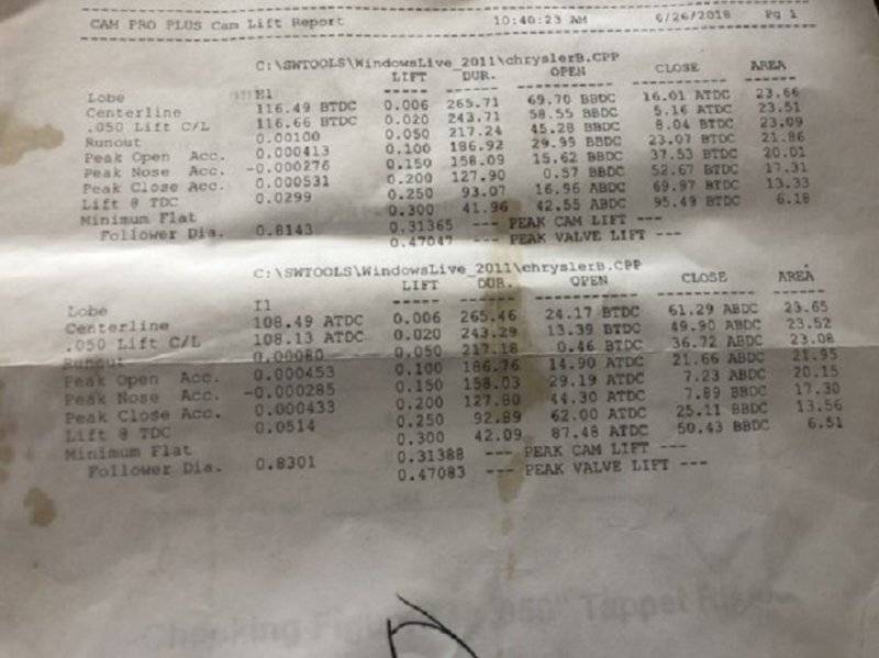

Thoughts on this cam?

440 stock bore, 452 heads milled .003, cast crank, ly rods, sealed power pistons I think we estimated compression around 9.6:1 or 9.8:1. Edelbrock performer intake, quick fuel 750 carb. Street car that I’m looking to get more out of over the winter.
What are your thoughts on this cam that is currently in it? How much is likely to be gained from a different one? Suggestions?

Honestly I’m not sure what all those numbers mean.
Why such a small follower diameter, or is this a roller diameter? Is that just the recommended minimum diameter, or the diameter used to figure the durations?
Anyhow, 217 duration @ 0.050" is fairly mild in a 440.
What sealed power pistons are they? If you are going by the description, they are probably going to be about 7.5:1.
Universal grind one size fits all master so seat to seat may be large for .050 duration

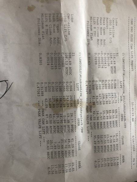

can you blow up photo and turn sideways?
And why different sizes?
why different minimum tapped diameter ??? good question
they do not appear to using a dual pattern cam with different masters for intake and exhaust
do we have a brand and part number?
stock magnum was 213-225 @.050 but VERY LONG Ramps, wide lobe centers
I'll try and read that printout
Printout Duration .006 265
lift .471 cam should work fine try it before switching so you know which way to jump and how far
Jones 256-454 (shorter real seat duration for earlier intake close for low comp and more at .200) above is 127@200 which is where the power flow is
some comparisons
Lunati @.006
253 208 454 all the heads flow, no special machining)
256 213 454
Howard 255 208 .479 @.008 so more real duration than lunati above
shorter duration than printout, same lift, should be more @200
would be good choice (or Jones if lower compression
Lunati 262 220 475 about the same duration as printout cam
Howard 265 218 502 more duration than printout cam but looks the same (difference in lift at measurement)
The problem with the Magnum cam is using it with low compression
It runs Hot
the late closing intake bleads off dynamic compression big time
and the late closing exhaust dilutes the intake charge (helps with smog like EGR)
The intake is somewhere around 300 @.004 and exhaust over 310
