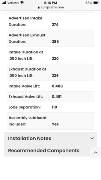

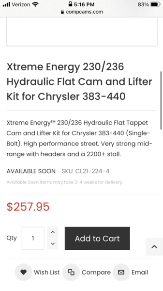

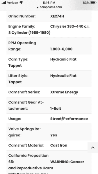

So a friend ordered a cam for a small block and they sent him this one by mistake. He was going to send it back but I’m thinking of buying it from him to use in my new 493 stroker motor.
Any thoughts or info on this can?
Personally I wouldn't use that in a 493" under any circumstances.
Good to know, but why?
Besides being a hydraulic FT which I don't care to use anymore, just not enough lift and duration for a big-cube motor. I've run that cam in the past in a stock 440 with headers and an RPM intake, and it was okay there; had a little sound and gave it a little extra kick beyond the factory cam. But in a 493"....it will peak the power lower, like low/mid 4000s (and likely nose dive after that) and even with a good-flowing head there just isn't enough cam to feed those cylinders.

That cam is pretty close to what Chrysler put in 383 and 440 Magnum engines. Definitely not enough lift or duration for a 493 stroker.
that cam closes the intake valve way too early for that engine. more seat timing would be a plus for 493 inches.
Depending on what you are looking for in your motor, that cam might be perfect. That cam is meaningfully larger than the factory magnum cam. But in the world of 500 in motors, that cam might seem too small for some people. It all depends on your goal.
That cam would give a decent idle and would work well with a 3.23 gear and a stock-like converter.

Imo, the XE274 is better suited towards a semi-hot 383 or a warmed over 440, than a nearly 500” stroker.
I had that cam in a .030 over 440 with Stealth heads. If I remember correctly, it made 489 hp and 520 ft lbs. Quite a bit of idle vac and it ran good.
