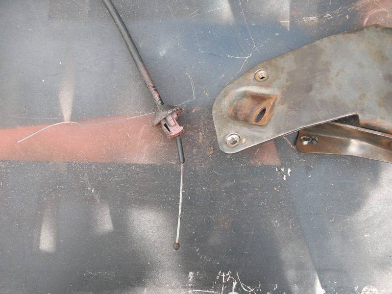

1968 Coronet RT, 440. I seem to be missing something. How does the cable attach to the pedal bracket? Even I know a square peg won't go into a round hole.
Never done one like that. It looks to me it has a push it in and a spring locks it. To me the spring is ok on left side of photo but none on right? Is there a broken edge? I could totally wrong.
What moparnation74 said. At a glance, it's maybe a '71+ throttle cable. The older ones are round with a metal clip that goes inside the car where yours is square with the plastic clips. The older ones are metal there too.
It's what was on the car when I got it. I could easily make it work, if it wasn't too long. I can't remember how it was previously attached.

That doesn't make it right for the car.
Have a search on Moparnation74's restoration thread as shown above - more than enough info there.

You can buy a used cable from any vendor dirt cheap or just buy a new one versus some piece of junk that won’t work.
Yes, that is a '71 ish year. That looks exactly like the one for my '71. It "fills" or locks into one of the holes in the firewall, in front of the accelerator pedal. The ball of the cable locks into the pedal and is held into place with a liitle "c" clip of sort, to hold the ball in the pedal

I think it would be very unjust if the incorrect assumptions made about me were to convince some people to stop giving me advice because they would think I would just ignore it . By the way, I bought the correct cable and I got the engine started for the first time since I bought the car.

Your picture had exactly what was needed to clearly state that you have the wrong part. Finding a good used cable from a vendor is easy, cheap and quick as which I provided that insight. However, you ignored those things mainly because you have a personal indifference with me and had to vent.
