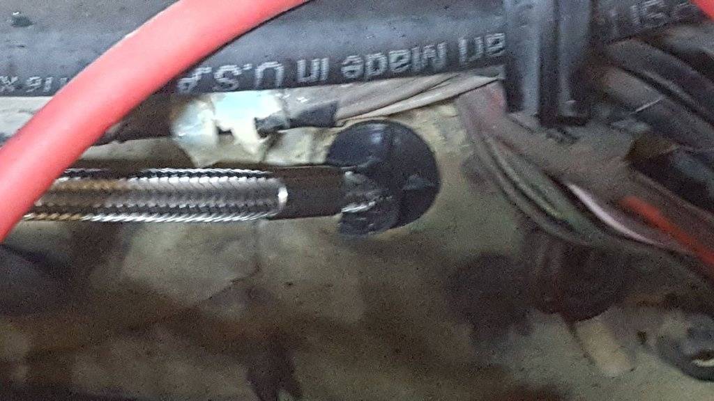

i have to replace my throttle cable ( 72 ssp with a 400 / 4 bbl), anyone have any recommendations ?? i went the cheap route.. throttle hung, almost cost me my car !!
the cable pulled out of the rubber grommet in the firewall , grommet is is split now.

This cable should not be mounted in a rubber grommet. The cable goes threw a metal plate and locked in place with an E clip.

does this help ??
