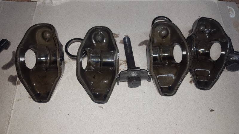

Pulled rockers/shaft on driver's side. I don't see anything that stands out. Looks like normal wear, don't see any cracks.
Shaft looks fine.
Pulled pushrods, all look fine, no interference, none bent.

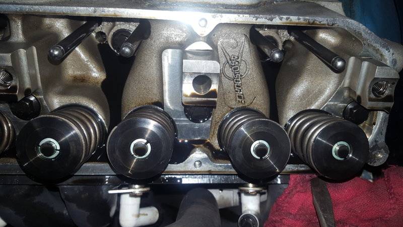

Valves/springs look fine.
Of course, I am not familiar with what everything should look like with normal use, but nothing slapping me in the face.

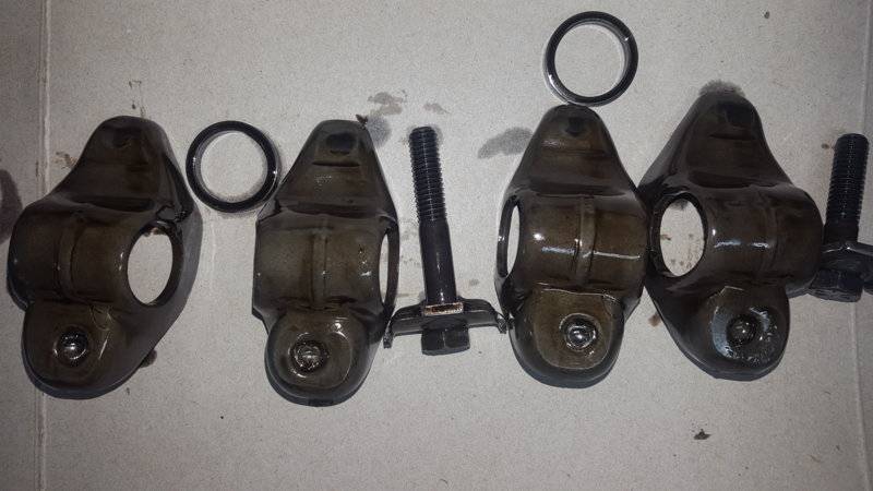

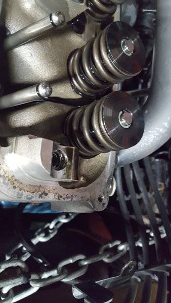

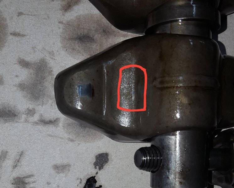

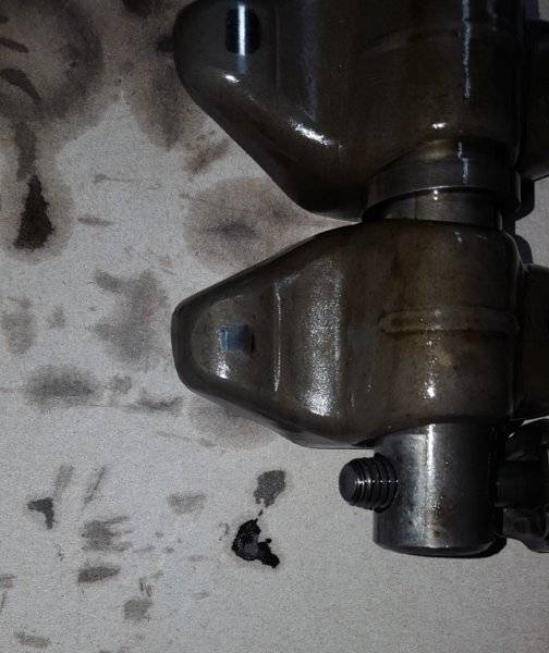

I think I found the issue.
#1 exhaust has a very small mark on the rocker, I don't see anything on the retainer.
Looks like it was rubbing on the very edge of the retainer, but no evidence on the retainer.
Same for #3 intake.
It sounded like it was coming from the rear of the valve cover area, but maybe not.
Is this enough for a ticking sound?
I barely noticed the wear marks, after only 3 days of examining everything over and over. Never thought the rockers could contact the very edge of the retainer, almost like it was trying to conceal the crime.
