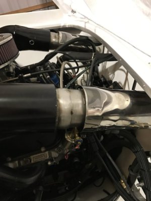

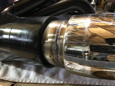

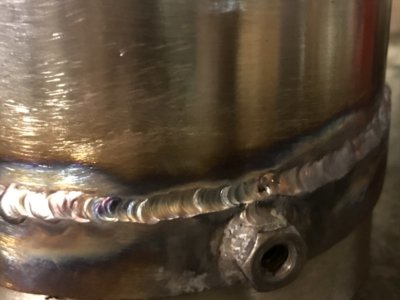

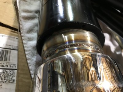

Here’s some stainless thinwall 4” tubing I’ve been working with. Far from textbook, but I’m learning

Youll get the hang of it. It takes "seat time" to get the technique down. Big difference from mig welding where the wire feed is automatic.
If you're going through a lot of gas, back it off to the limit then increase just a little. Clean, clean, clean your pieces. Any oil, dirt ect is bad. Forget about your mig welding techniques, tig is a form of torch welding. Just enough filler rod as you go and just a little wip of the torch. Use the proper lense for your eyesite. Seeing exactly whats going on in the puddle is of the utmost importance. Its why i have a hard time with a consistant stitch. My eyes aren't what they use to be. Flooding your workpiece with good lighting will help also, even when mig welding.
Keep up the good work!
If you're not useing a flow meter, get one!
Post flow gas being used up might simply been improper setting. A good start is to learn gas welding then this comes easy. Many guys buy newer computer controlled tig machines, an expensive way to start. I would find a used Miller DX 250 for 500-750.00 and have a 10,000 machine. So what if its 25 years old. All come with frequency start.
If youre not useing a flow meter, get one...
My post flow is not adjustable on this machine.
It’s factory set for 1 second of flow for every 10 amps. Aluminum eats it up as I’m practicing on 1/8” and 1/4” aluminum plate and with the 1/4”, I’ve got the amperage cranked up.
I have a flow meter.
I did buy a 2.0 magnifying insert for my helmet. (Amazing what seeing the work does for a guy) I have a miller helmet and they make great inserts for guys like me who can’t see **** up close anymore.

You need to learn to "cup" weld the joint. Were talking pipe here. First of all open joint pipe or tube when tig welding stainless the joint has to be purged of oxygen. I assume this was not a open joint, no matter, master the technique of walking the cup and your joints will look great.
By walking the cup. It means you hold the torch at a angle, have the tungsten set properly and guide your hand while the cup is touching the work piece. The cup is rocked slightly back and forth as you move it and feed filler material. Its the same for steel.

With the stainless, there is a really fine line between not enough and too much heat. At first my welds were way too hot and the welds looked Smokey and grey.
