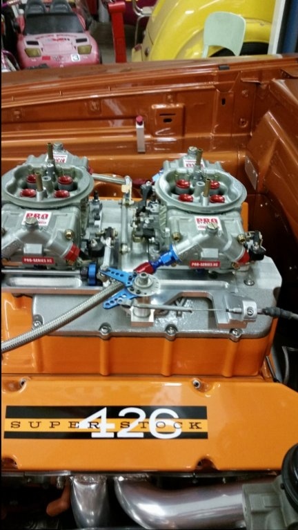

Here's the 2 set-ups run on my current car. The Pro-Systems have been the quickest at 9.02@149. The Edelbrocks have been 9.04@148. All are 750's. The Edelbrocks idle better (Holleys have the power valves blocked so idle us fat). A pair of the PS are about $1575, the Eddys are about $690. Though The PS are very nice, is .02 worth $900?
