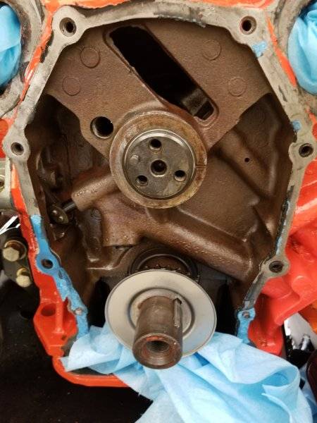

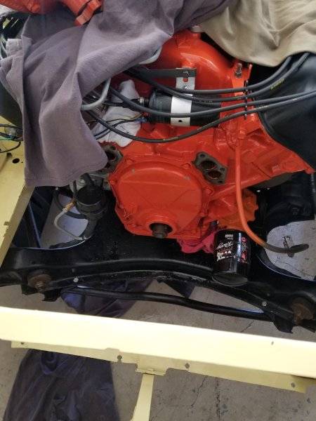

Sure can, easy stuff. Make sure the gasket bolt holes line up on the bottom side of the timing chain cover before applying sealant. Here's a few pix from the last time I did it.

You should also loosen a couple more pan bolts that go in the block. This will allow the cover to come off the dowels easier.

So I need to loosen the front oil pan bolts. I think I see the dowels in the one picture.
