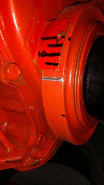

In my example below, I discovered mine was dead on fortunately:
I didn’t use a piston stop but I did use a camera in the #1 and rolled it both ways. Marked the damper on movement and split the difference. Came up within a degree or two of groove.

Something about that picture just doesn't look right for a 77 engine.
Not my picture, I have a cast crank damper.
