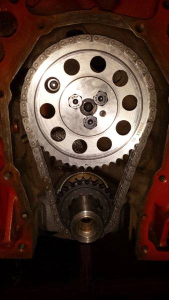

What are your thoughts on the torrington bearing-equipped timing gears, in NON-roller cam applications in the big-block Mopar? Some say use it as the bearing prevents wear on the block surface. Others say don't bother....

I used one from SA Gear, on my 470, fit perfect and never had a timing issue, plus it was a double roller.

I believe you're correct Fran, however I was thinking of the gear sets that are made with the bearing. They should fit and locate the cam just as a regular set would?
That's right, I remember you mentioning that...I guess if they're made to let the cam locate normally it's maybe a little extra insurance against gear-to-block friction. I have an SA in my 440 but it's a single-bolt version with no bearing.

So far no issues with my Summit timing set. Been on the road three years. I do recall this set had a bearing on the back side to ride against the block.
