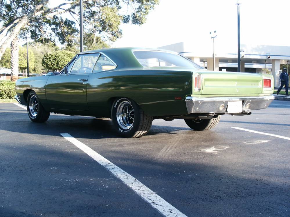

My pleasure. Here is another shot of the driver's side rear 3/4 view. I like the look of the 15" wheel/tire size better than the 14" because it fills the wheel wells just a bit more and makes the car look more "compact" for want of a better word. I have a set of the road wheels and some 225/70R-14 tires and it looks okay but not quite as good as the 15 inchers IMHO.
