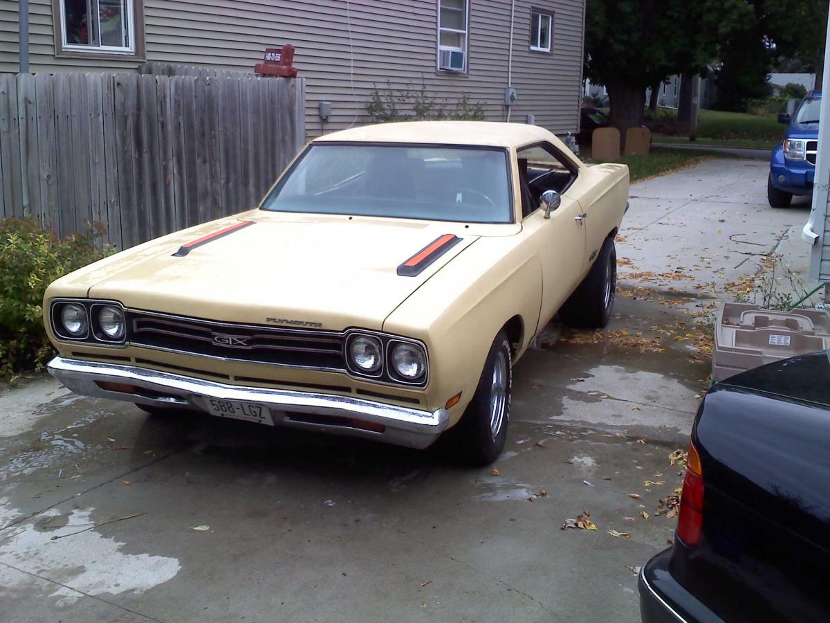

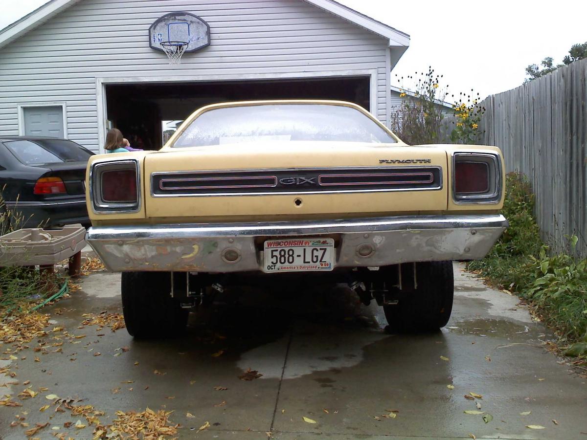

i got a good deal on my rims and tires $250 for all four with decent tread however do to the rim, i have to have the car jacked in the rear. anyway rims are american racing with mickey thonmpson indy profile n-50's in rear not sure the offset of my rims but looking at my tires on car the 50's would fit in my well if the rims were in 2" wich i do have on the back side
cool 69 more pictures please
its actually a 69 gtx its still in progress hence the yellow primer i do have more pics but i figured they didnt pertain to this thread. im only a 26 year old kid with not alot of money but doing what i can with what i got and so far ive come a long way, ill through some more pics up of its current condition since you asked i got it early last summer it was supposed to be a complete car just very much apart, it was more like a rolling chasis in rough shape with some various parts ive had to find or fix almost everthing car is supposed to be auto but converted to 4spd wich i prefer anyway but right now ive got it in storage till spring when ill start working on it again, i hope to paint it early this summer.
Sweet-*** 69 Did the valve covers come with the car?? never seen ones like those before... got working air shocks on her? or is the rear height just from the shackles??
BTW like pepsi do ya?? :rolling::rolling:
no the engine in it now is just my temp motor it was a $600 black grease ball when i bought it so i degreased it took it apart put new timing chain and gears scrubbed the heck out of the carb and rebuilt that put all new gaskets in the engineand sprayed it with some hemi orange engine rattle cans from local parts store valve covers have a matching air cleaner that i bought off ebay for like 90 for the set and for the pepsi ya ive got alot of hours working on this so needed some sort of stimulant. and i say temp engine because i have a 440hp long block that i plan on rebuilding and modifying a bit, i have a 550hp goal but that wont be for a few years need to finish the car and get it reliably driveable first as for the rear let me first start by saying the leaf springs under this car were shot with the car on its original tires the leafs almost sat flat not too good so when i put these tires uder it i got the drop shackles and that wasnt enough so i bought these leaf spring helper springs for 40 said they increased load rating by 1500lbs. that got the car to sit off the tires but if you hit a bump tire would rub so i went back to autozone and they had this coilover spring kit that you can add to your shocks so got that for another 40 and now seems ok however i was looking through summit and found new replacement leaf springs for like 110 a side so i ordered them out now but havent installed them yet
