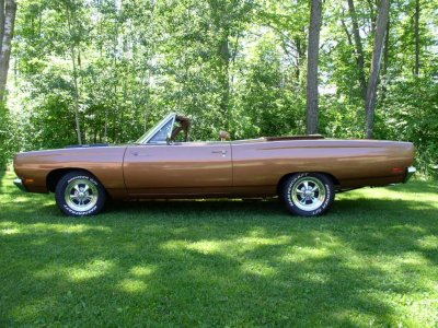

When I went to the 225's, I was able to drop the front end about 3/4" by unscrewing the torsion bar adjusters. This made up for the taller tire. I have a 69 RR conv. that I am running 245/60/15 on front and 255/60/15 on the back. This setup looks good to me on that car, but it has the original rear springs which make the rear sit a little lower than my hardtop.

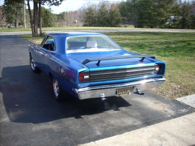

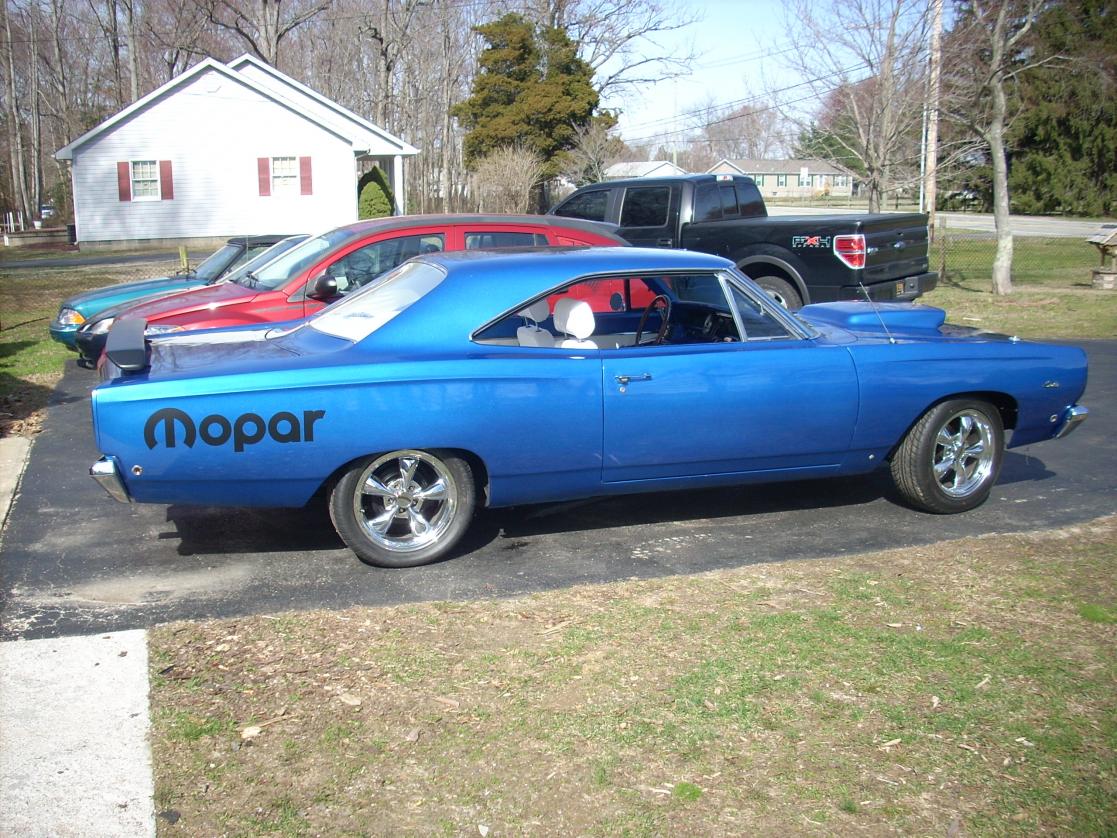

I went through this as well. The picture in the grass is with 225/70 & the other shot is with 245/60. The rears are 275/60. I ended up using the 225's for two reasons, In order to drop the front end to cover the tops of the tire(the look I like) I had way to much of a rake look. The 225's are closer to the heighth of the rears and look more proportional while filling up the well better. I am using the MP HD rear springs and have about 1" rake. So I have a brand new set of 245/60/15's I will sell cheap if you go that way, lol.

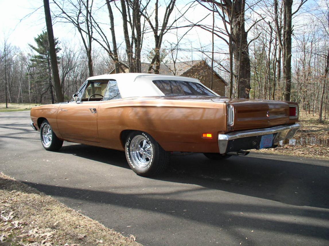

The rear springs on my hardtop are not the super stock, which from what I hear raise the back quite alot. Mine are the plain hd springs which were used on the hemi & 440 cars. I don't have a decent side view of my conv. on blacktop, but it also has 1" of rake. In my opinion I think it looks best if the rear tire is no more than .75" taller than the front. I did try 275 & 245 together and didn't like the look as there is 1.5" difference between them. My original plan was to use 295/50 with 245/60. Loved the rear look, but they didn't fill the wheelwell up enough for me. Maybe with your lowered rear this would work. Do you have any friends with the different sizes on their cars that would let you bolt them on yours to see if you like?

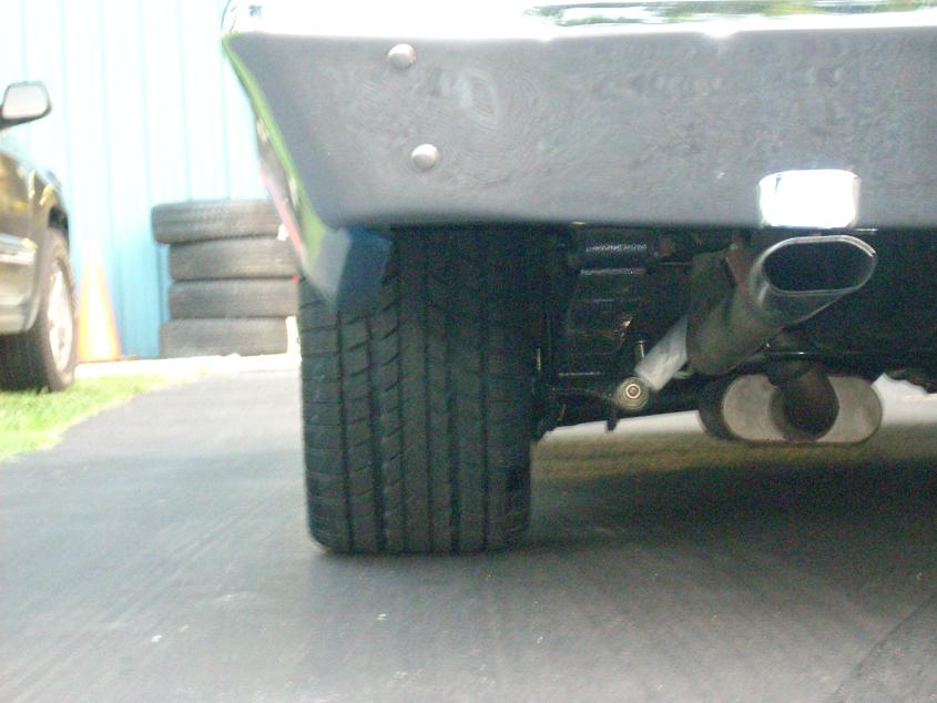

On my 68 Sat I have 315-35 17's on 8 inch rims (replica alloys), zero offset. Could stand a wider rim but they don't make the any wider in this style. I am pretty sure with a little positive offset, I may be able to get 335's in there. No, they dont rub or hit anything. No air shocks, stock shakles. 235's on the front.

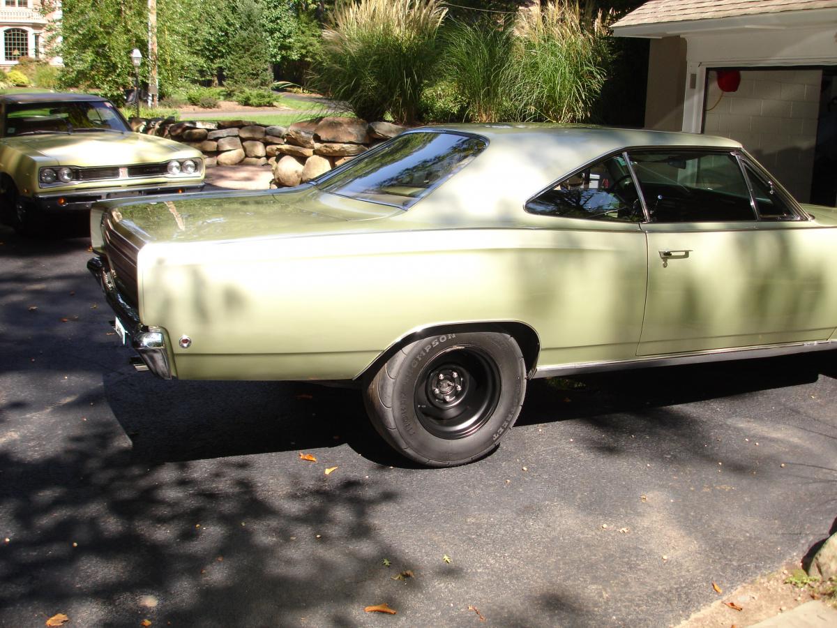

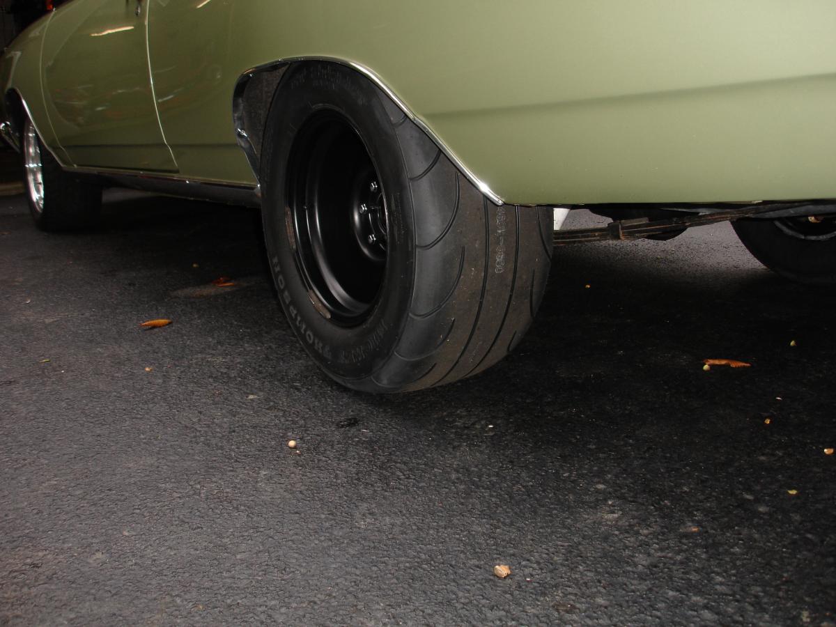

295/55/15 w 4.5 inches of backspacing on my 68 Satellite

Hunt2elk - man, you are on top of things! Thanks for the quick response. The 1" rake looks perfect on both of your cars. OK, I'm going stick with the 275's in back and swapping out my 235/60's for 225/70's. I will post before and after photos in a few weeks. I will keep my hotchkis rear leafs for now, but may swap them out eventually for either the Mopar HD springs like you've got or the Calvert racing split monoleafs, which allow you to swap the front half of the leaf to get the desired ride height.

it is a 15" rim with 4.5" backspacing. so far no rubbing but that was with air shocks jacked up. I just put in new kyb gas shocks and new bb rear springs. I'll let u know if she rubs in a few weeks..

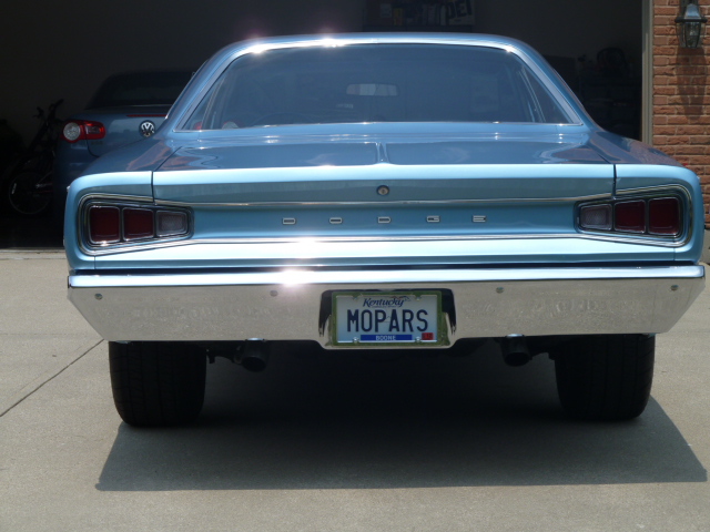

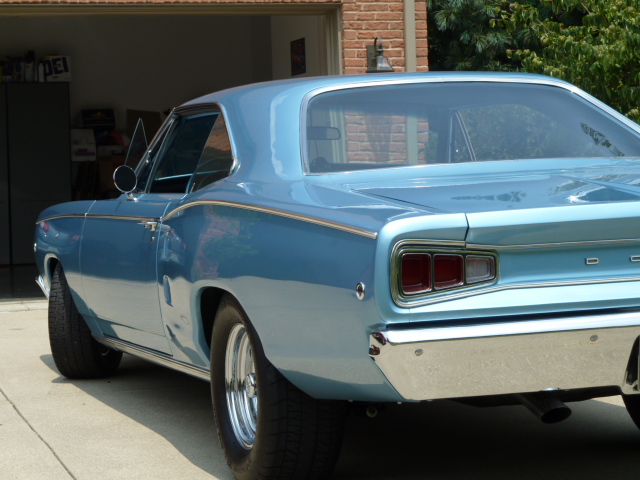

I have 275/60-15 BFG TA's Drag Radials....with 4.5" offset
