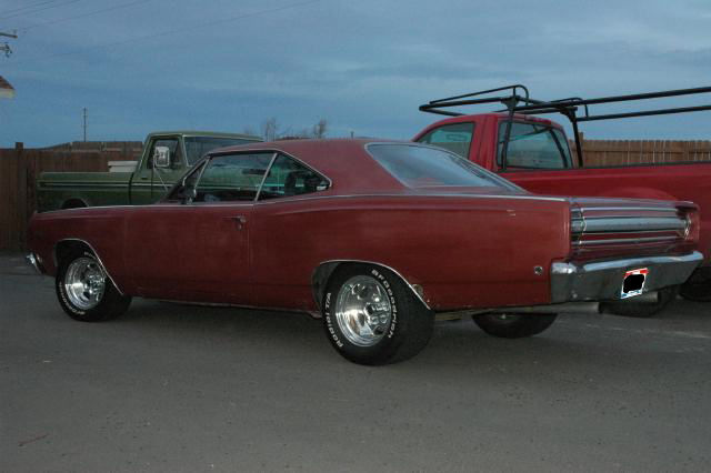

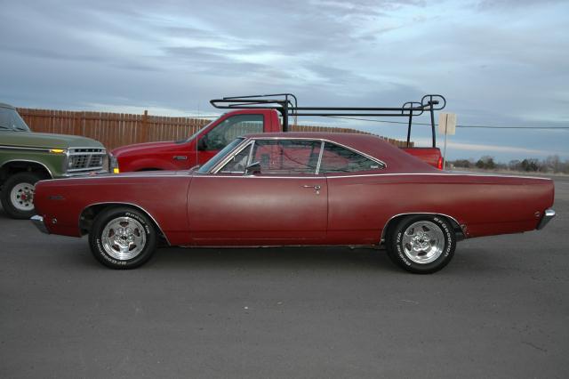

Here's a shot of my 68

68SS - Your Sport Satellite looks like a real clean car, NICE. Here are a couple of pics, hope it helps. The Centerlines have more than doubled in price lately, Summit has the 15X10's for 300 each. My recommendation, either 15X8 or 15X9 with 275/60-15 rears. Look at 69Roadrunner69's photo gallery, sweet car. This tire size just looks a little better from the side, larger diameter, fills the wheelwell front to back better, not so much inner fenderwell, framerail, etc. showing. Added plus, less chance of rubbing somewhere.
Satelliteman -
That's it - I'm sold on the Telstars. Thanks very much for the side photos. I agree - I'm going with 275's. The front currently has 215/65's on 7-inch wide wheels, but I installed Hotchkiss front suspension (upper control arms, steering rods, and struts) and I'm a little worried that if I put 8-inch rims up there it will make contact with one of those parts. If I keep the 7-inch wheels, I've heard I can go up to 235's, but again, I'm not positive I won't have any interference issues. I'm sure 225's will fit, but the overall height would look smaller than the 215/65's I have now.

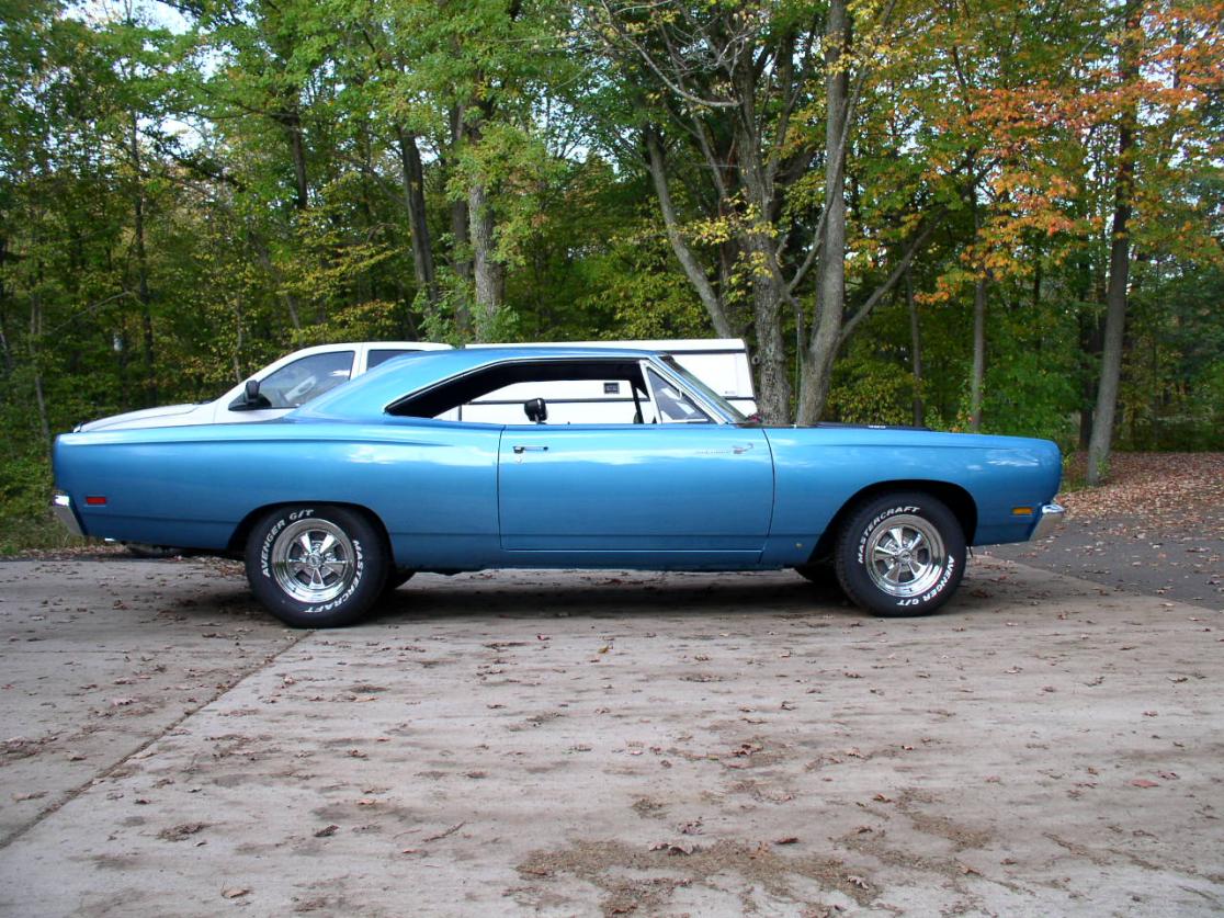

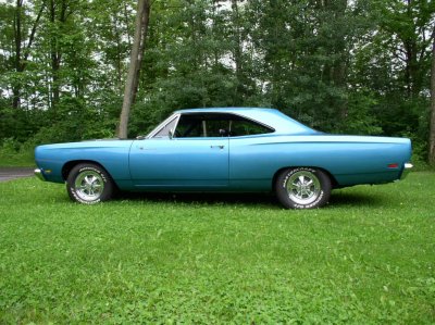

I went through this as well. The picture in the grass is with 225/70 & the other shot is with 245/60. The rears are 275/60. I ended up using the 225's for two reasons, In order to drop the front end to cover the tops of the tire(the look I like) I had way to much of a rake look. The 225's are closer to the heighth of the rears and look more proportional while filling up the well better. I am using the MP HD rear springs and have about 1" rake. So I have a brand new set of 245/60/15's I will sell cheap if you go that way, lol.
Awesome! This is just what I needed. Thanks for the quick response with the great photos. Is the suspension setup and front ride height the same in each photo? If so, I would say the 225/70 looks better. I guess if I went 245/60 in front, then I should drop the rear size from 275/60 to 255/60 to balance things out. Otherwise, like you say, it's too much rake.
