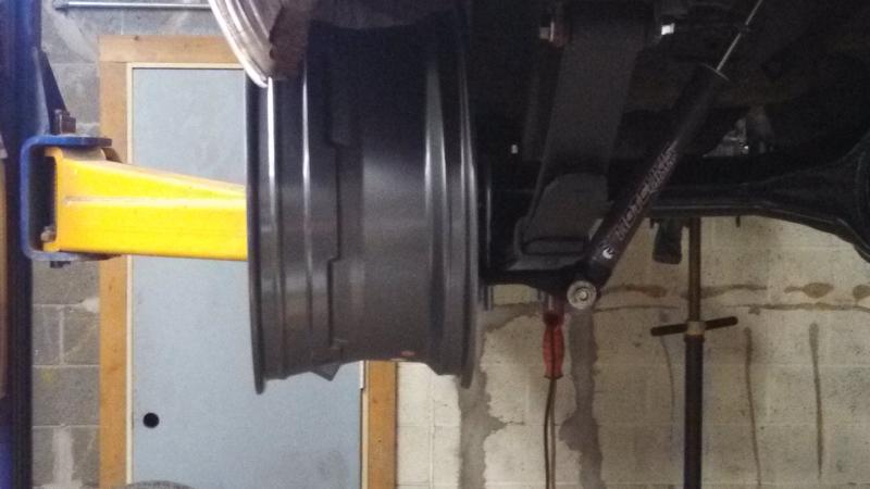

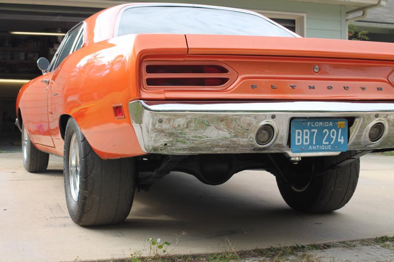

i got 18x9.5 with 275 out back with 5.75 backspacing...i got plenty of room. hope this helps ya out
