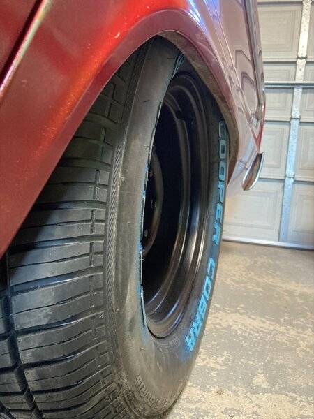

Hello All, I got new tires for my 66 Belve 275/60/15 as you can see in the pic they are a little too wide. Does anyone have a trick for me to make these work without shortening my axle, or ordering new wheels with more backspacing. They fit on the inside just not on the outside.
Thanks View attachment 1194098
Wrong wheels
The tires are new, and desirable. The wheels are new, and desirable, and will probably fit numerous b-bodies, just not yours. Sell the wheels/tires, get the wheels that fit.
