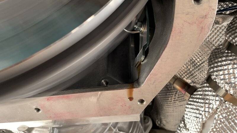

i have the inspection cover off the tko
going to dry up everything as best as i can then going to splash some baby powder up around the area. also will setup a gopro to video to see if it can capture anything

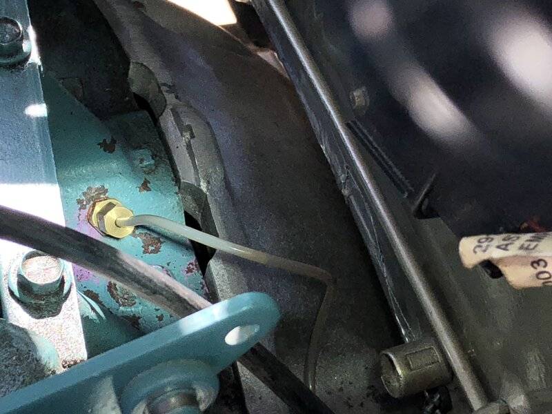

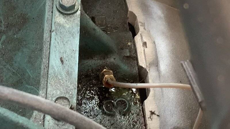

update - might be an issue with posting pics on the website or my device but anyhow - looks like leak is flowing from oil pressure port on top of engine and flowing into the bellhousing. attached pic is after oil and port cleaned up

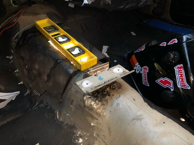

before you start chopping the center console brackets out keep the rear one in (partially - see pic). i found i had to weld it back in but just chop it in half.

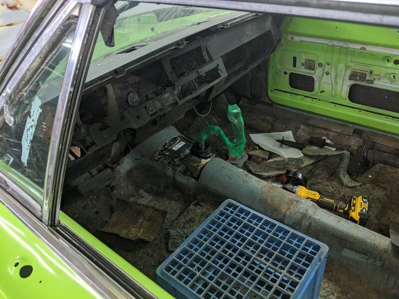

I have converted cars from automatic to 4 speed in a few days but that was using all factory parts.
I've been looking through the instructions here and there are some procedures involved here that go well beyond a stock for stock parts exchange.
The bell housing centerline runout, correction if needed......Hydraulic clutch setup....Measuring and cutting the floor for clearance, etc.
I thought this was a NO cutting deal! I thought the only cutting was the hole for the shifter. I'm okay with that, I just didn't know that there was this extra step.
Currently in the process of installing my SST kit with a 5.7. So far I believe the only cutting I've had to do was the shifter hole in the floor, which in my case has to be QUITE large as my car was an auto, I think the hole is about 12x16 at this point. There's a plug in the firewall for the clutch slave so you just have to drill three mounting holes for that and two holes for the clutch pedal bracket. I may do some further cutting for any other modifications but AFAIK the big a** hole for the shifter is the only cutting.
That is what the instructions show in my case as well.
If you're competent bending more complex shapes in to sheet metal you shouldn't have much trouble bending the SST sheet metal to fit the floor but in my case I'm planning to fab something up myself to make things a bit more serviceable.
