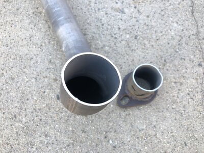

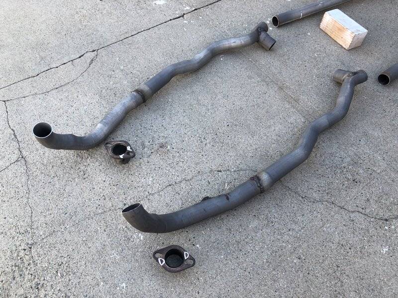

ehhh.....the bends and such out from the base of the exhaust manifold were tailored to a 727 and also the ends on the inlet side of the mufflers are angled inward towards the driveshaft...too many factors to correct.
gonna order a universal 2.25” steel/aluminized kit off summit and make a new exhaust system
im going for the worlds longest 727-to-tko500 conversion record
watermelon

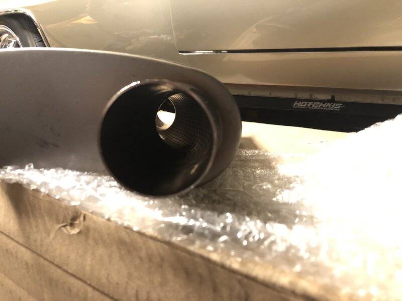

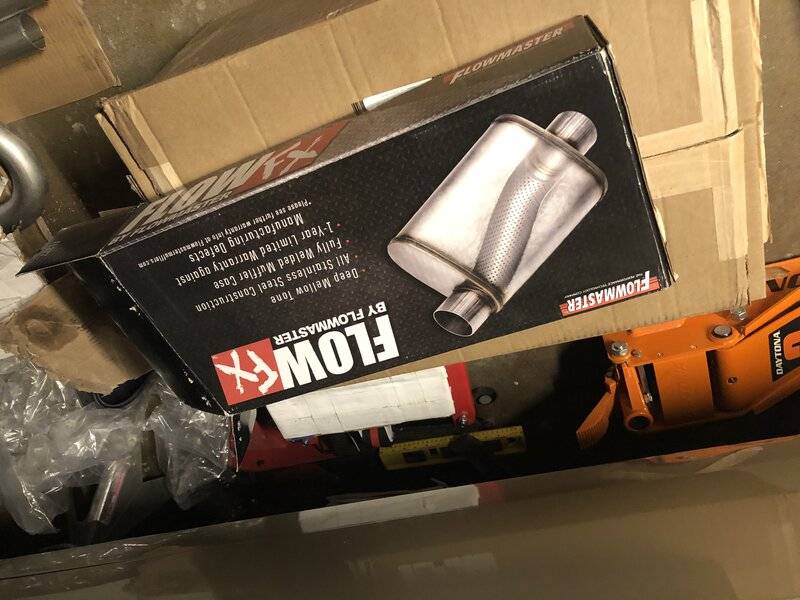

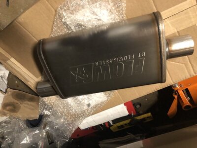

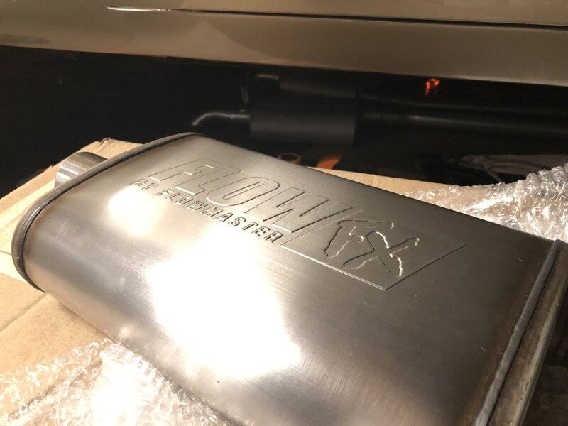

ordered 2.25 universal exhaust kit in aluminized steel from Summit, 2.25 Summit H-pipe kit, and 2.25 inlet/outlet Flowmaster FlowFX mufflers.
i hope to get it all in and running by the 27th............................................................................................................................................................of September

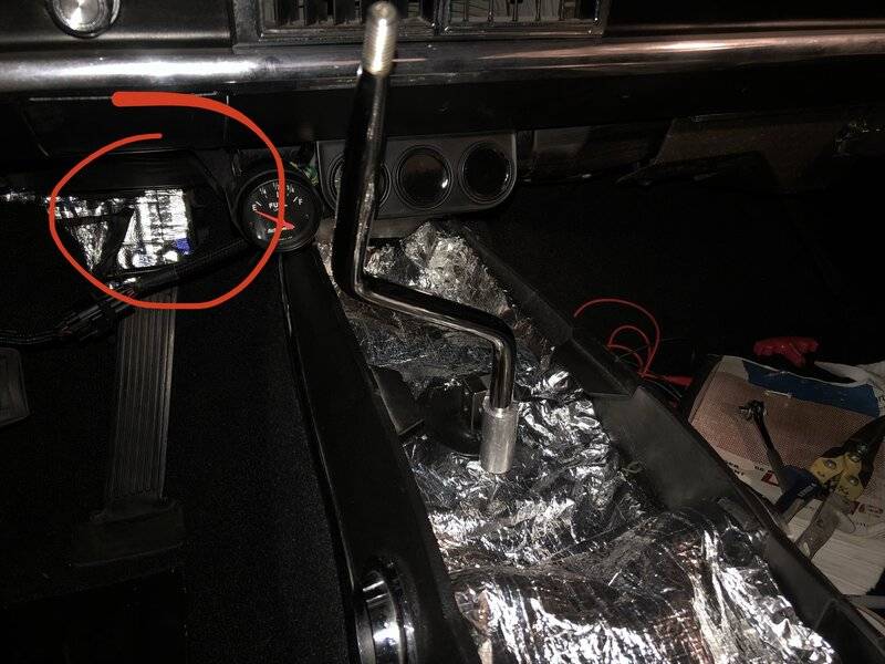

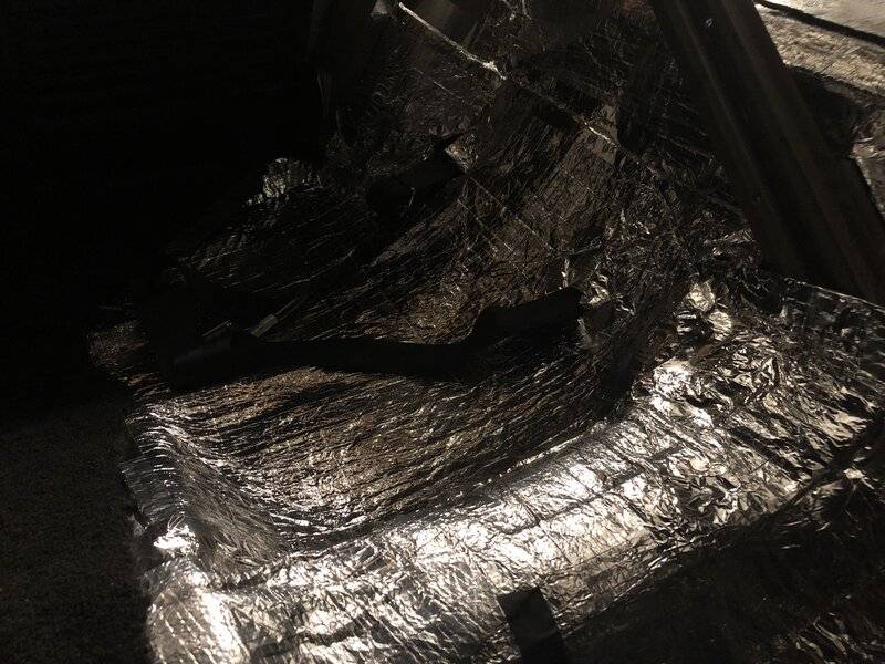

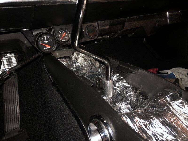

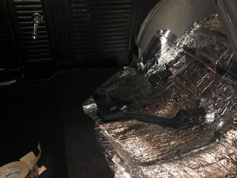

whats been nice about not having anything to do next is that i’ve be able to focus on the noisiest part of the 66 - the center console. this thing is louder than the Flowmaster setup.
still had some leftover ThermoTec Thermo Gaurd FR roll so i layed a few extra layers in the rattle box. the SST kit really makes it look like the 1966 was born with the TKO500.

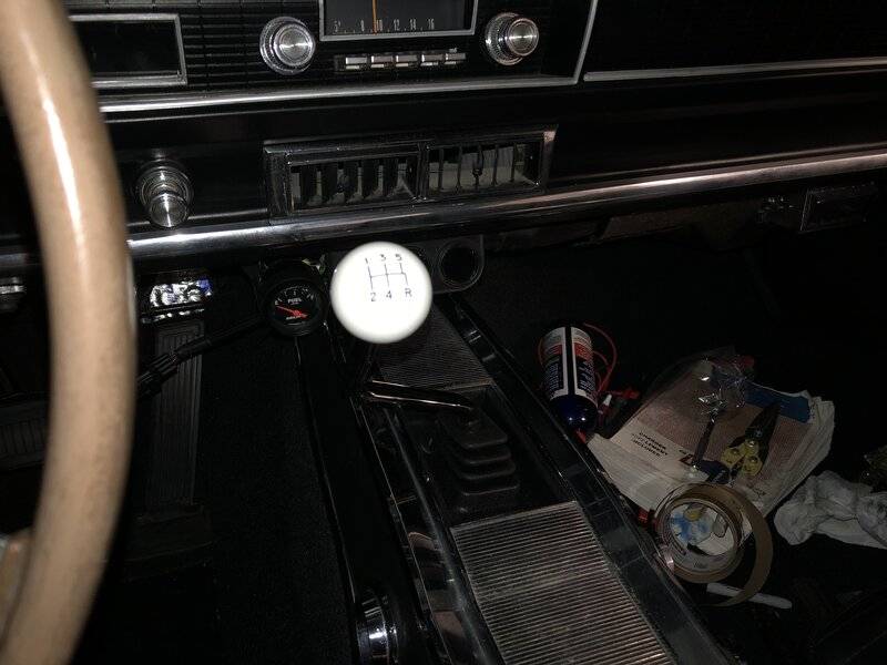

the flip top section needs adjusting but i think that will be easier than building the exhaust or sliding in the TKO500
all i can do is wait for the new stuff to come in. i will lay down some black tape over the shiny area under the foot pedal area...i don’t need distractions when im rowing through the gears......heck.....the only other stick shift ive driven was a 96 Honda Civic back in 96

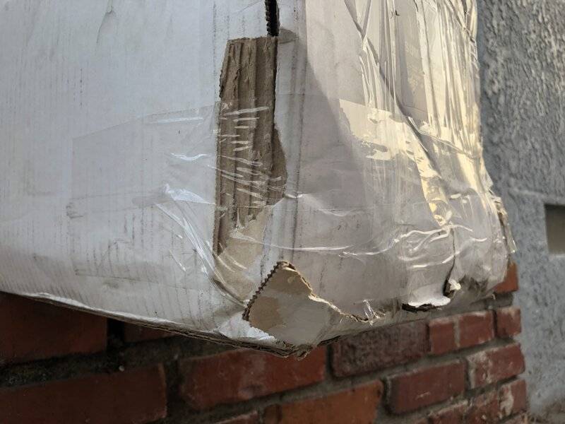

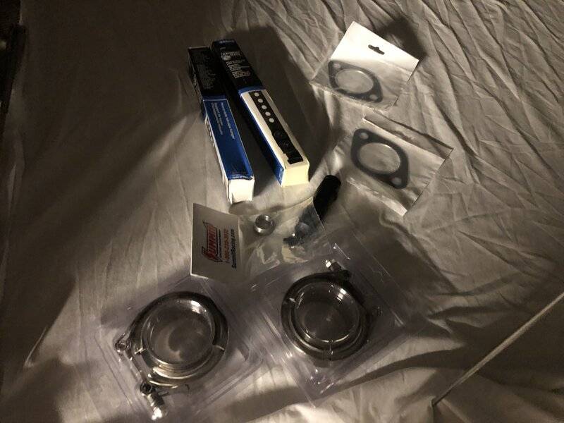

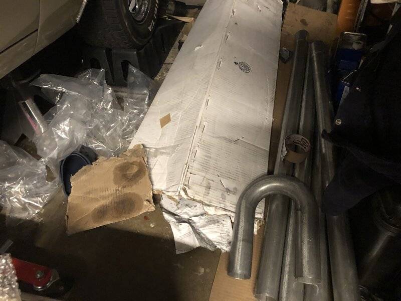

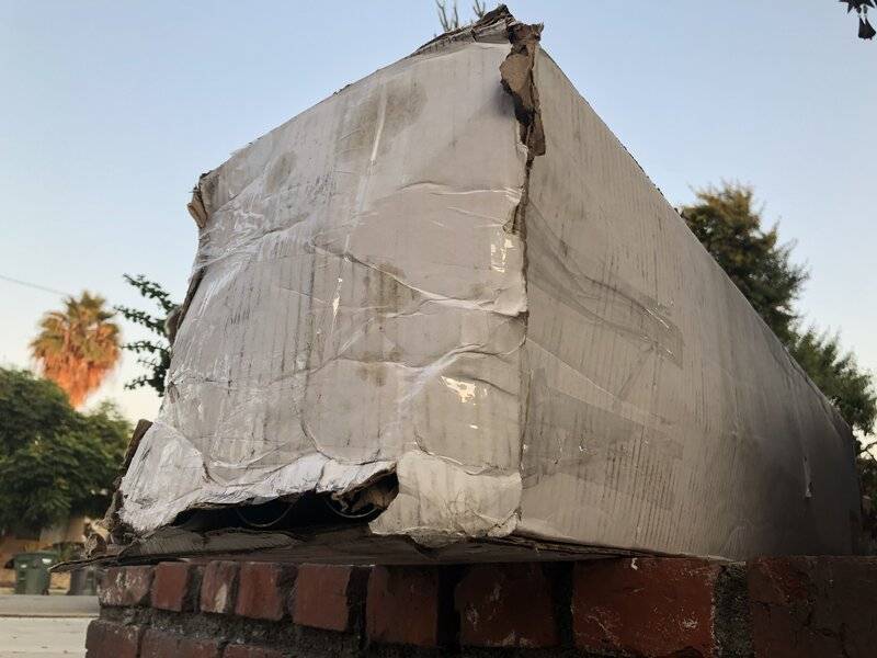

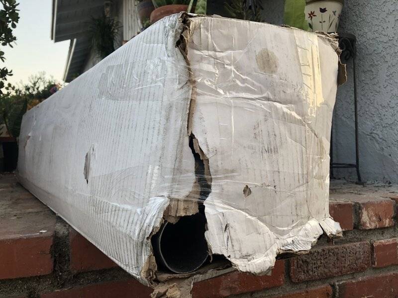

UPS man put in some OT and dropped my summit stuff off....sure it got beat to hell and missing a few lengths of pipe and they slipped in gaskets instead of 2.25” 3/8” flanges but f it...ill proudly tell highway patrol UPS knows i drive a beater. let’s see how far that gets me.

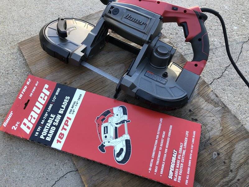

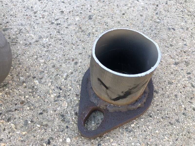

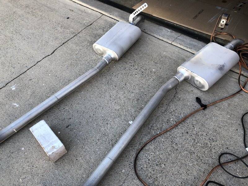

cut up old exhaust and keeping it handy just in case
used a HF Bauer Bandsaw and their 18tpi blade. cut it like butter and left clean smooth faces
watermelon
D6DD269D-2244-4C1F-81E9-C9363DF6E03B.jpeg CA13787E-1DAE-46BF-B86B-11667BA79421.jpeg 7CB8E5EC-B9CE-4BB8-B419-199A1DFBBD44.jpeg 2AD3D3A4-A6A1-442E-AAB2-B029A68AF25A.jpeg E0560FAA-1B76-4B35-8915-C2BC044D938A.jpeg 4120B7F0-0CAF-489E-8FFD-3647AC072966.jpeg

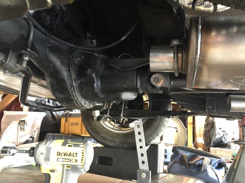

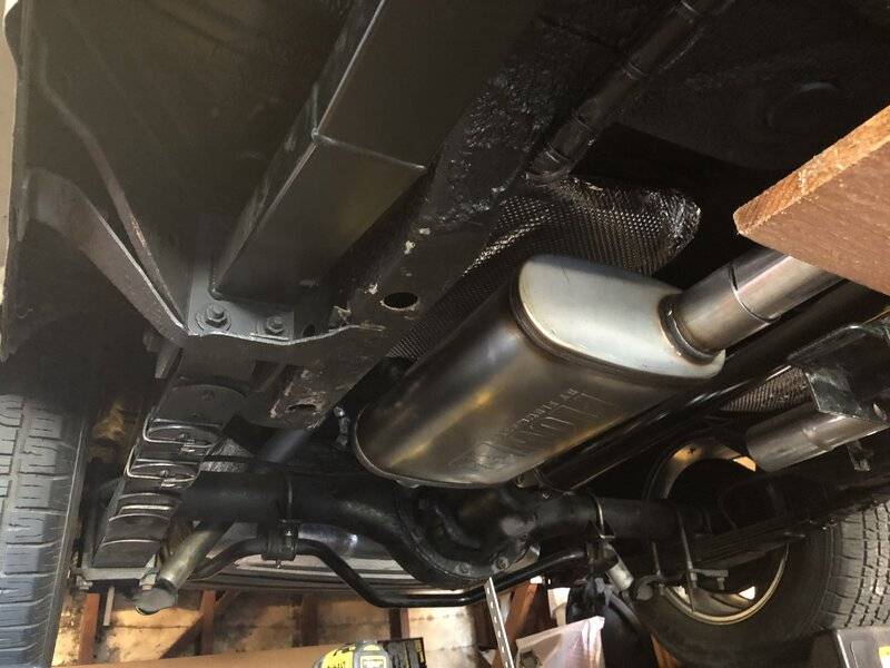

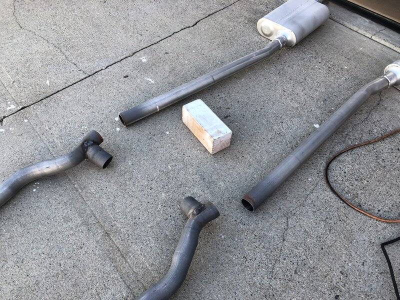

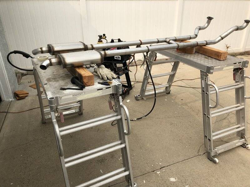

going to have to keep exhaust dumping out before the axle due to the Hotchkis rear sway setup; it takes space between gas tank and rear frame rail area
just cutting and tack welding away for now

So you endorsing the Bauer band saw? Id been looking at the Milwaukees but hard to swallow the price difference...
Yes - watermelon endorsed - the Bauer with the HF 18tpi blades. Set on number 7; use your own Allen key to lock in the guide. Cut a few scrap pieces first to get the feel then go to town.

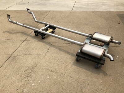

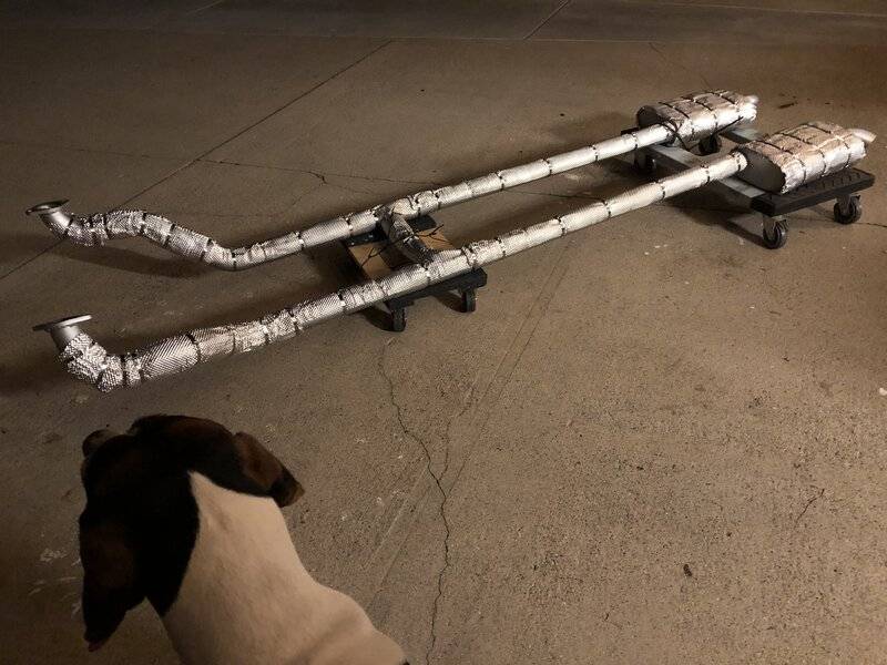

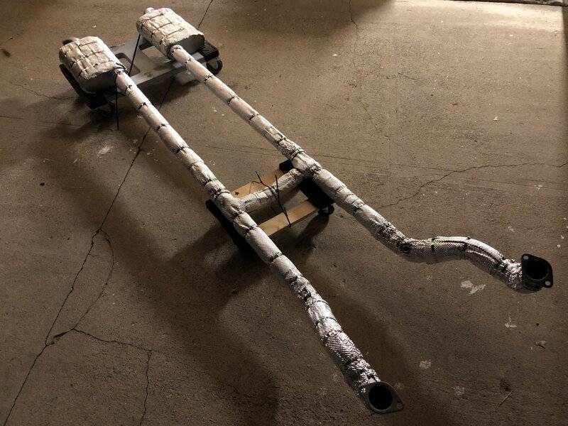

all welded up, painted, and wrapped. should fit this time. the dogs can’t wait.
