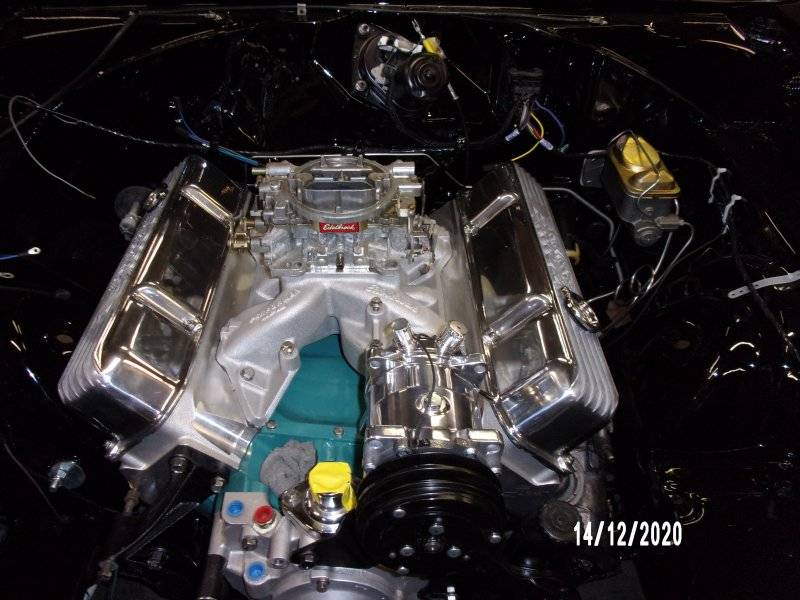

I have wondered if the 440/495 build I did was necessary for me to have fun with the car.
Necessary? Probably not but so what? I wanted to do it.

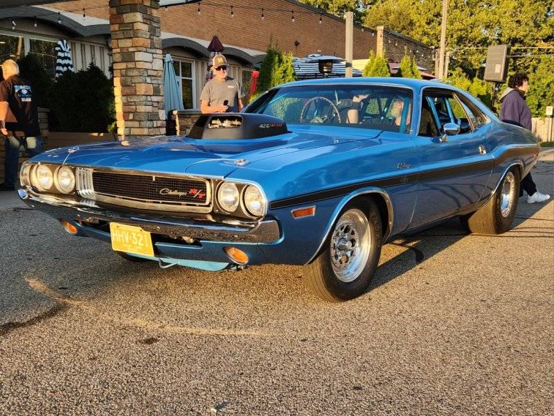

My Challenger has a big ole hole in the hood with dual carbs poking through as well. I made the Super Shaker scoop to clear it all. Just in case I get caught in the rain while out crusin.....
