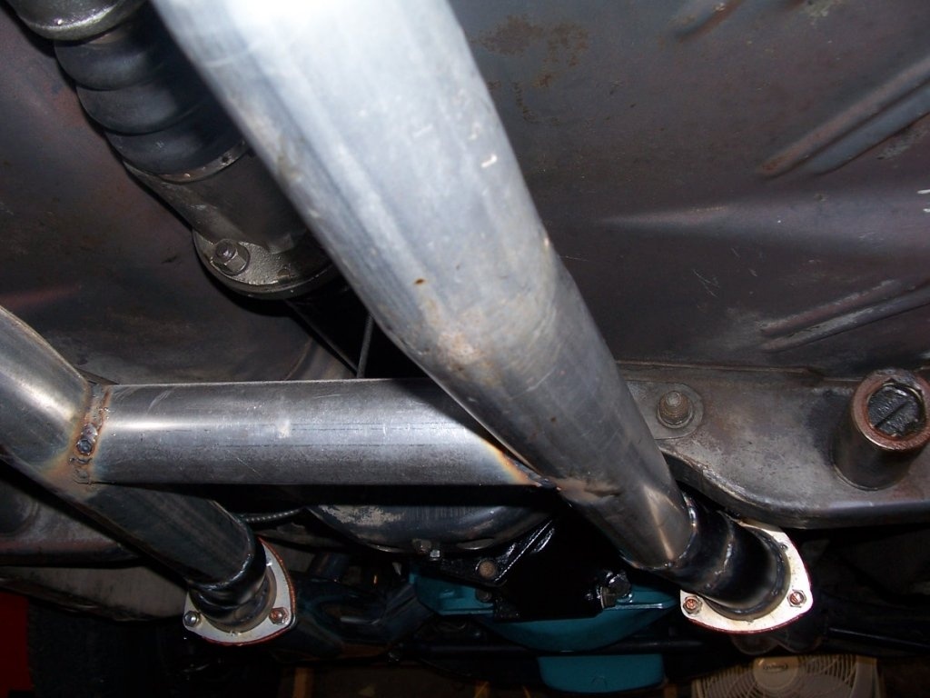

TTI....H...helped

If you ask the self-proclaimed Master of Mopar, Mark Worman, he says the HP manifolds are as good as headers when it comes to power... according to some new magical tests someone has done. As for me, I say that's BS as there's a lot of different types of headers out there and while the manifolds may be on par with a couple, they are not on par with all. :)
If you want more power, and better sound, go with headers. Granted, they are a pain in the ***, but they are worth it.
I would go with headers just because I like the sound of 'em. I would probably go with the Doug's ceramics myself. I like the TTI's if money's no object. Definitely keep the cast manifolds with the car.

Touching on the Doug's vs TTi again I really can't find a difference. I'm debating the 2 brands for my 383 right now and from everything I read I can't find anything saying TTi actually offers a better quality/performing/fitting header. For the price difference I think it's just a brand loyalty question. If anyone can chime in comparing the two I'd be really interested to read more.
Yes, I think the TTI's are overpriced. That said, they are 12 years old and live a hard life. I would buy them again in a heartbeat. Guy that installed them said they fit good. Just one ding-L- do ya for the pitman arm.
