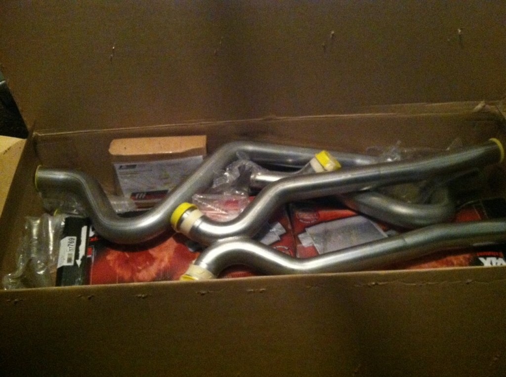

Want these? :-)

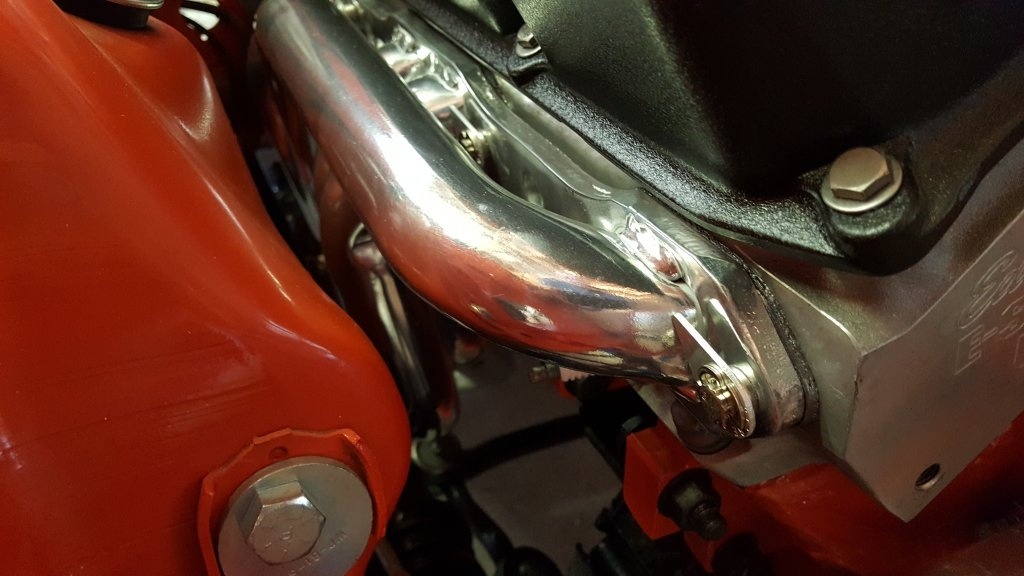

Although on a '71, Doug's headers ceramic coated on a 400 motor with power steering, Remflex gaskets and mini starter. To the OP or who ever is thinking of headers: Do yourself a favor and get a set of Stage 8 fasteners and be done.

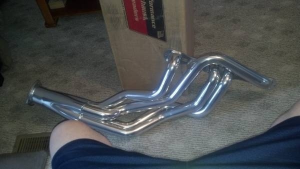

IMO TTI, You'll be glad you did. yes they are pricey but you get what you pay for. sell the manifolds for a couple of hundred and put the money to the new headers. "you'll never be disappointed buying the best "
TTI.jpg TTI 2.jpg View attachment 390202
