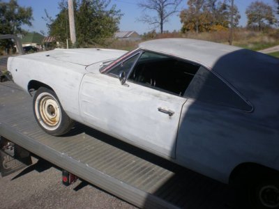

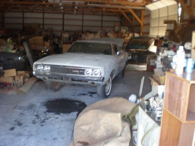

I'm wondering how many of you guys have pics of Primered B-bodys? I have a project that might ONLY get primered. I've seen many cars "done" in primer or a flat/satin paint that look great! So I thought I'd throw this out and see what comes of it.
I actually have it pretty well set in my head that I'm going to be painting my 1966 Belvedere "Satin Black". Looking into making it into a saturday night cruiser/bruiser/racer. But some other pics might change my mind.
Thanks and take care. :cool:

Almost be tempting to leave as is and preserve the "patina"- just make it safe/fast/fun to drive and enjoy the hell out of it- would beat worrying about door dings in $10.000 paint jobs (but those are nice in their own ways, too...lol) mostly just build it the way you'll enjoy it the most!
I think you're right about satin paint vs primer. Leaving primer without a top coat will rust back through pretty quick, as it's supposed to absorb moist paint, and if allowed, will absorb water. My 70 Bee was mostly primer and I went through about a can a week.
NOT fun sanding and spraying at least one square foot patch EVERY week.
If you want to keep the car for ANY time at all, you'de better put a good top coat over primer or it WILL rust away! Single stage has come a long way if you dont want to have the time, and money in a base-clear package.
I used a single stage paint over DP-40 epoxy sealer-primer and like how it looks!

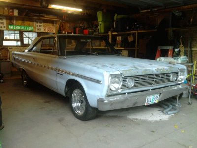

My 66 looked like yours for nearly 10 years of driving! One night on the way home from work some moron in a Mustang pulled up alongside at a light and laughed at it/me and when the light turned green, I stuck him for 2 car lengths before he could get his act together lol. I was only running a slightly modified /6 so he was faster but the 66 moved very well when stomped. The best part of that came 2 weeks later at the track. Yup, pulled up beside him at the tree and cut a nearly perfect light and ran the number. He didn't plus he broke out. He wasn't laughing anymore :D Some laugh at that kind of paint job so be ready to shut them up with driveability

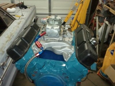

I definatly have plans on having the motor to impress at least SOME people. Its a .030 over 440 balanced with worked over 915 heads, mild Comp cam, Streetmaster intake (I know the pic shows an Edelbrock performer), Demon carb, FBO distributer with ign system and an MSD box, big tube headers, 727 with 3000 dynamics converter, 391 gears and a small amount (100hp shot) of bottle fed fun! Oh yea, prob this winter or next summer... mini-tubbed.

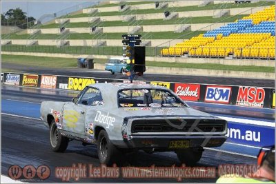

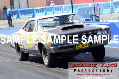

like this

And why are you going with a StreetMaster? I call them StreetBastards. That Eddy Performer would be much better and the Performer RPM would be even better. The only thing the SM has over a stock manifold is it weighs less.
I have wanted to run the streetmaster for hood clearance and because it seemed to flow a little better than the performer? I have the opportunity to buy a Torker 2 for about $75 and have thought about that but am worried about getting too tall on the motor and running into the hood with the air cleaner. Wanted to run the thickest air filter I could too. Better suggestions being that you ran the same car Cranky? My other thought was to stick with the performer and with the NOS plate it'll help gain some top end RPM range.

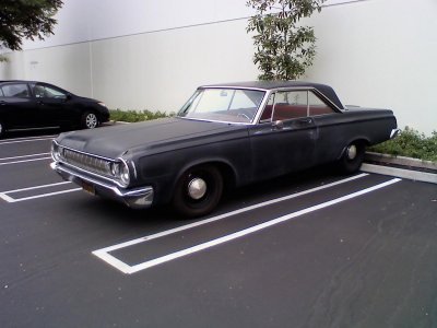

oh not not another satin black car!
i personally feel thats a cop-out, there are so many tinted primers out there why try to make the car look like a RAT ROD with a primer black finish i'm stuck with a satin black 1964 polara and it totally takes away from the muscle car look, i am so temped to rattle can it any color just to lose that rockibilly look... or maybe i should just paint the rims red and complete the "look"

Yeah you diffidently have a point there, your car looks like a v6 rat rod only because of the color.
