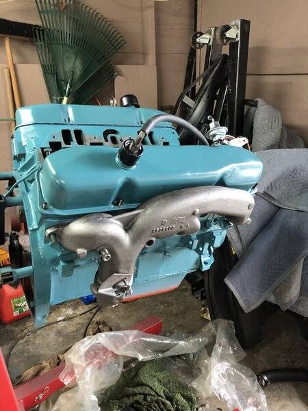

1964 361 original 2 barrel to a 1970 383 HP, fresh 516 heads .020 head gaskets giving about 9.4:1 compression, magnum cam with heaver springs, larger SS valves, Edelbrock Performer intake with a 650 Edelbrock AFB, HP exhaust manifolds with 2” exhaust.
Should be quite a change……..

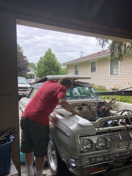

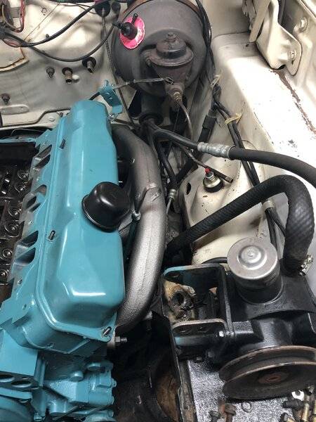

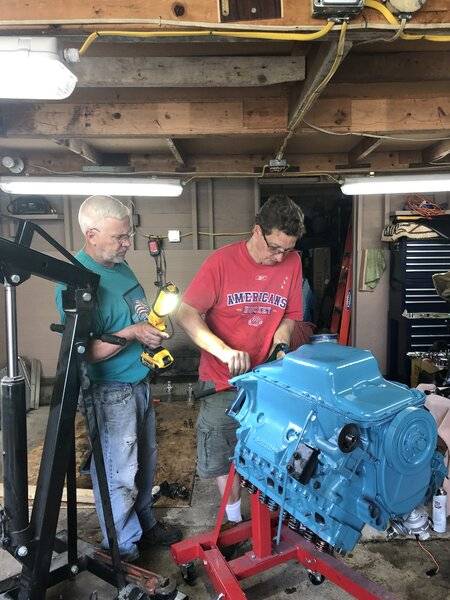

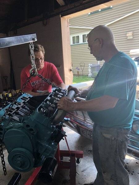

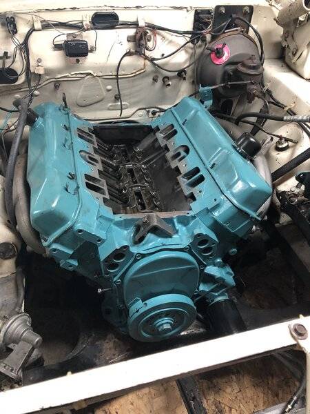

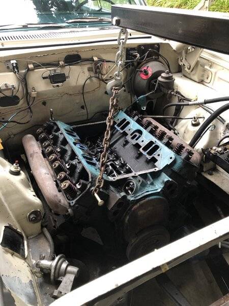

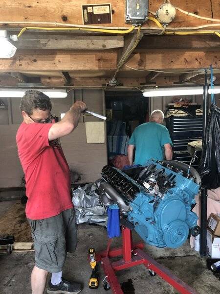

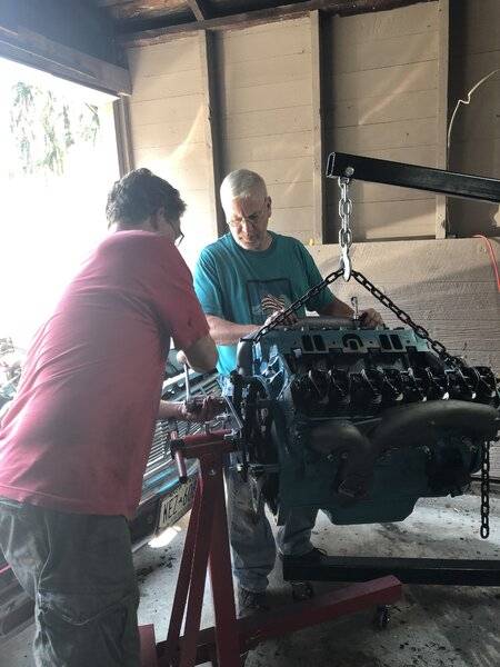

It’s in, now to put everything back together, huge thanks to Don and Matt, real gentlemen.
D2A7BD31-D1B7-4BB9-8188-51772EEAD50D.jpeg 1DD39D67-766C-41C4-87F8-62AD3E1F0ECD.jpeg 2D9E2C61-57C2-4A85-8350-2D1E564174A5.jpeg FFA20C4B-8899-47BB-919B-5C27A2BE32B3.jpeg CF792973-EF87-4541-BB02-EBCEF7574A21.jpeg 1222D0D2-2916-40D9-B3B5-6CFB21362949.jpeg
These two guys could have stayed home today and relaxed but instead they drove down to help me, this is what makes this site what it is.
