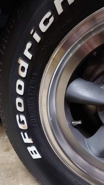

Sorry, it has taken me this long to get the car back on it's wheels. A lot of work over the winter! Ended up going 15x7 with 3.75" backspace all the way around.

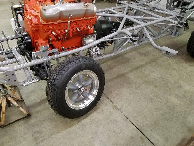

Question for the Torque Thrust owners. Do they use the shouldered type lug nuts, or the standard style tapered seat nuts? I am considering trying TT's on my 67 R/T. I currently have 14" road wheels on my car with chrome lug nuts. And, of course, the left hand threads on driver side. I would like to use the same nuts, and really DON'T want to have to replace the LH lug studs! Thanks.
This is what came with my new rims when I bought them.

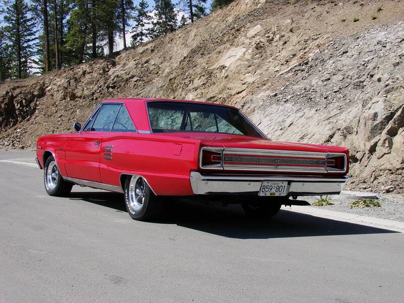

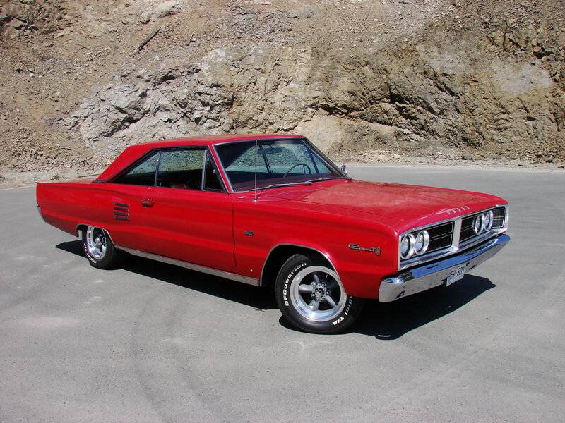

This is the setup I am leaning towards but what is your backspace? I had planned on just running the 215/70 front and back.
See comment above. This is exactly what I was thinking but you can only get the Torque Thrust in a 15x7 with a 3.76" backspace. So in reality, going with the 15x7 with 3.75" backspace, I should gain 3/4" clearance on the inside and .25" clearance on the outside over the 15x8 with 4.5" backspace (if I did my math right These I run on my 1966 Charger with room to spare.
