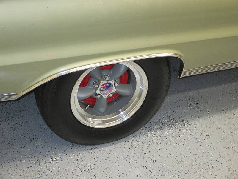

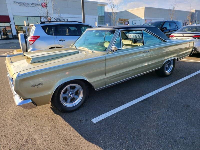

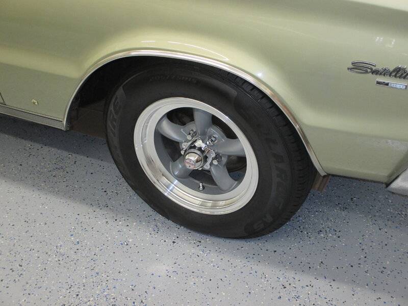

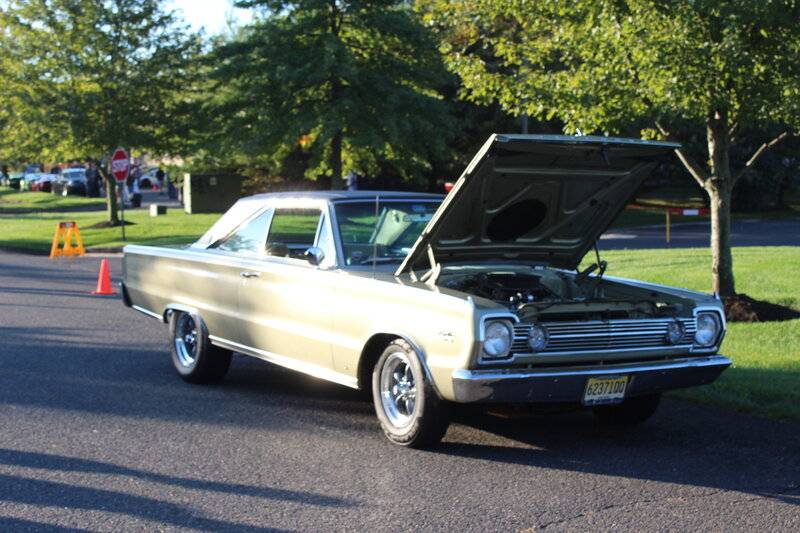

I run TT 15x6 front and 15x8 rear. Front tire is a 215-75-15 and rear tire is Mickey Thompson 28x10. Rear bs is 4.5.
Ron
Scoop was on from previous owner.
Ron
