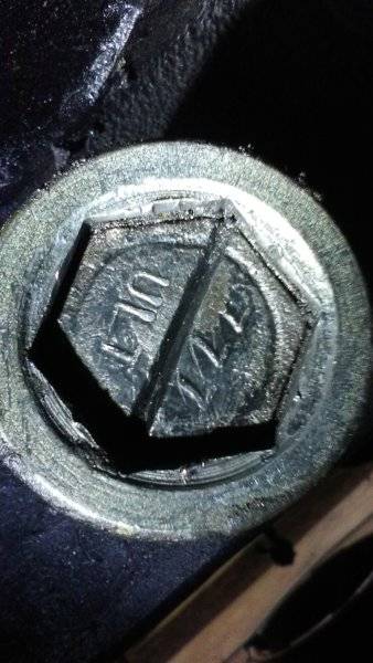

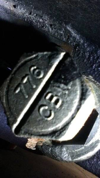

Does anyone know what these numbers mean? 1st picture is the left and is stamped: 777 ULT... 2nd pic is the right and is stamped: 776 CBW. I'm guessing 777 for left and 776 for right (odd left, even right), but have no clue what the letters mean.
I like my suspension on my 67 Coronet raised and to get it where I liked the look, one bar was cranked nearly all the way in, the other bar, maybe a little over half. I'm wondering if these are the original T Bars or replacements. I also wonder why so much difference in adjustment to get the front the same on both sides. Is one bar more worn than the other? Did someone install two different bars with different thicknesses? Not sure what's going on, maybe these numbers will help if someone knows what they mean.

The numbers are the last 3 digits of the part number. I’m using .960 bars from Mopar Performance on my 65. Got the ride height I wanted, the ride is fairly decent.

777 left and 776 right should be 383 two barrel engine, unless factory A/C, then the next step up as below was used.
779 left and 778 right should be 383 four barrel, which is the standard bars for a 68-69 road
runner, A/C or not A/C.
440 HP and hemi was 781 left, 780 right. period.

Hmmmnn, that's odd. According to my fender tag and Vin, my car is a factory 4 bbl 383 car without air.
So since one is nearly cranked all the way in and the other about half to get the front even, I'm thinking the one is just really tired and worn out. Maybe I will try the Mopar Performance .960 bars.

the blue mopar parts book spells out the application regarding the numbers. my 66' coronet 318 car has 777 left and 776 rights.But that old poly weighs as much as any 383.my 67 Plymouth 383 has the 779 left and 778 right.

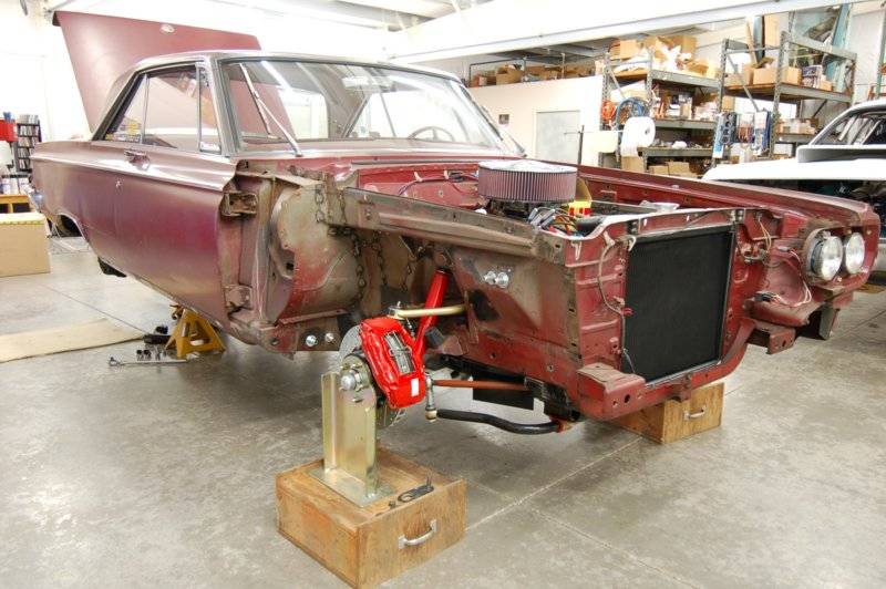

I just finished the front suspension on my '67... New QA-1 upper and lower control arms, all new ball joints and all new tie rod ends. After all this , I have exactly the same problem... The left Torsion bar is cranked all the way in, the right is about half and the left side is still lower. I was hoping the new bushings would help this but it did not. I think I'm going to try new torsion bars before I waste getting an alignment, I think my left one is just too tired.
