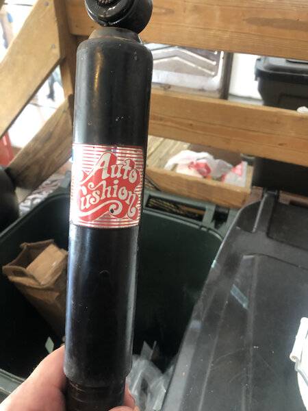

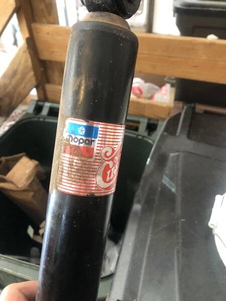

He is my follow up. I installed 4 new KYB shocks, the ones that came off the rears were Mopar Auto Cushions and completely shot. The fronts were Gabriel maybe…but older. I also installed the .90 bars. Not a hard job at all.
The front now has some support but not stiff. The rear is better but the those six cylinder leafs are soft but no bounce.
All and All I like the feel and it went in the right Direction for sure.
