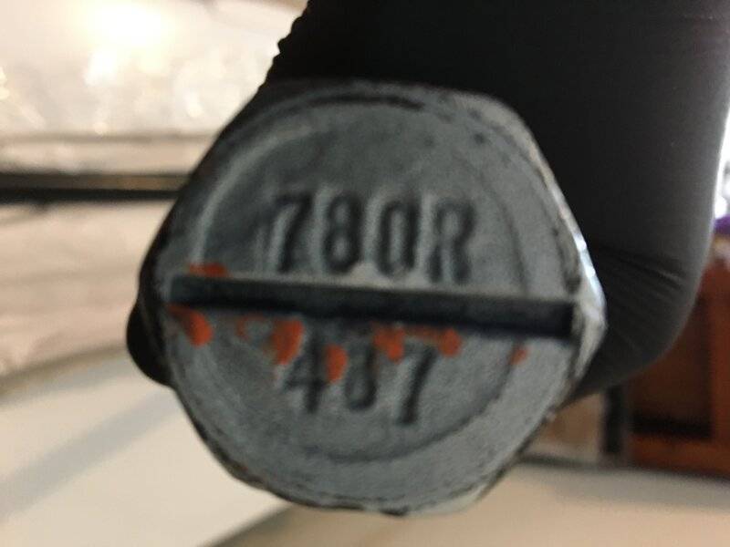

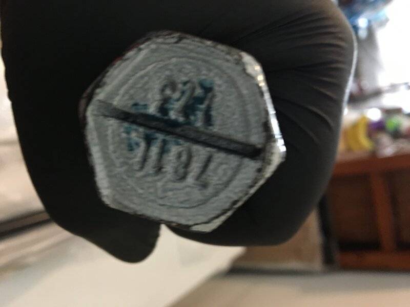

My 70 RR's torsion bars were a little pitted so I found these MP Hemi torsion bars at Classic Industries: P1857780 and P1857781. I already have Bilsteins and loved Bilsteins vs previous owner's KYBs, but I can not tell the difference that much with newer bars, but nice to have something newer in place.
