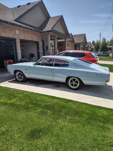

I recently returned from Carlisle, logging 800 miles on the round trip. I noticed that the car has considerable body lean when negotiating those long on ramps. The car is a 66 Charger with a 361 and factory air. The suspension consists of stock torsion bars with the stock front sway bar. The shocks are new and it has new 17 inch wheels and tires. The car rides great and handled severe bumps really well. My first thought is that it needs stiffer torsion bars to control the body roll, but then I got thinking maybe a larger front sway bar might do the trick without affecting the ride. I am not looking for a recipe for a 4000 pound corner carver, I just want to make the car more stable in the corners.

Beautiful charger!
