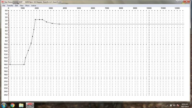

Here is the graph I've prepared for 110.
Distributor locked out at 38. Pulling 4 that gives me 34 Total with 22 Idle.

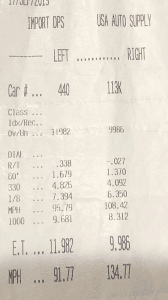

For amusement here was my time slip....obviously left lane. I had to let out at the 1000' mark as seen by my 1/8 mph (95.7) being faster then my 1/4 mph (91.7)
