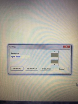

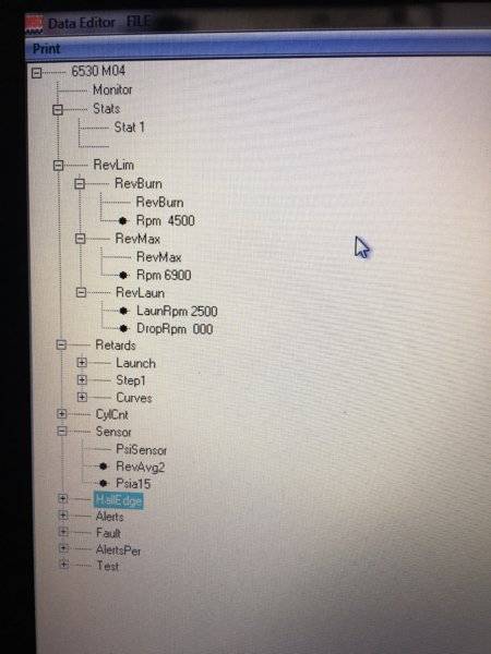

Here is the navigator and then a picture of it expanded to max RPM. think if I just put in zero RPM it will turn off?

So it looks like the lowest I can set the Rev Limiter to is 2700, and I still don’t see a place in the tree to turn it off completely. I may need to call MSD

FYI MSD also said that in order to turn off the Rev limiter completely I need to Set the value to the highest available in the software.
Set the limiter to the limit at 12500 and it pulls straight through 7200 and feels pretty good no popping or flames. I guess that confirms it’s a Rev limit issue. Going to send box back and see if it fixes the issue.
