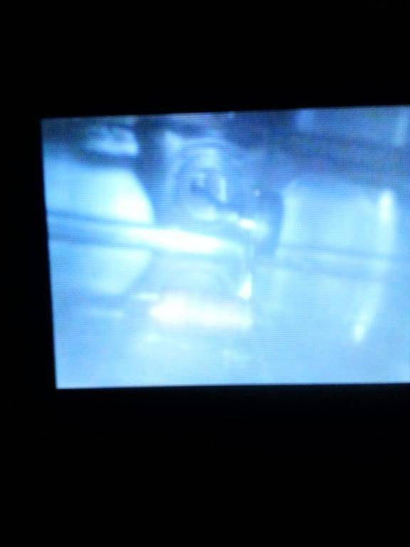

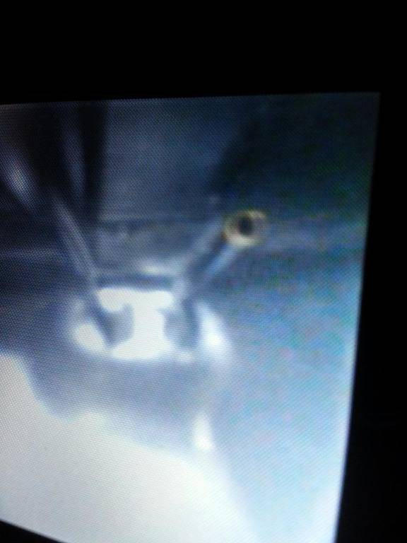

Here is what the inside looks like, this is not a great pic but the reflection at the center is the level of gas. The gauge read just over half.

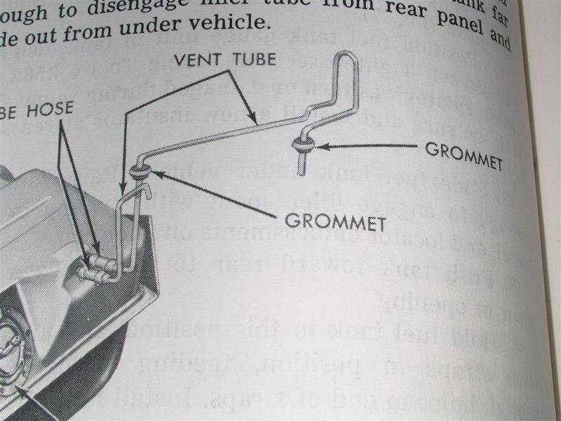

Vent tubes from the inside, short one on the left, long on the right, so if your parked on a hill gas will rise up the long tube down hill and the short tube will be under water so to speak. so the vent line that goes through the trunk you want on the short one. ON AFTERMARKET TANKS. mine was replaced some time between 86' and 94'
What is should be per the FSM
