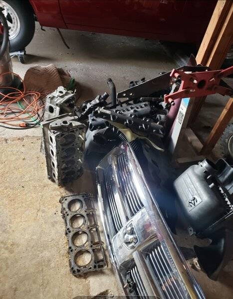

Just developed a slight tick and shut it down immediately due to the 5.7's reputation.
Another project, just what I need.
https://youtube.com/shorts/vlvwjwmTIrI
It had not yet thrown a CEL...

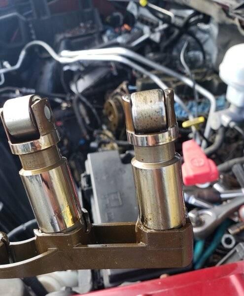

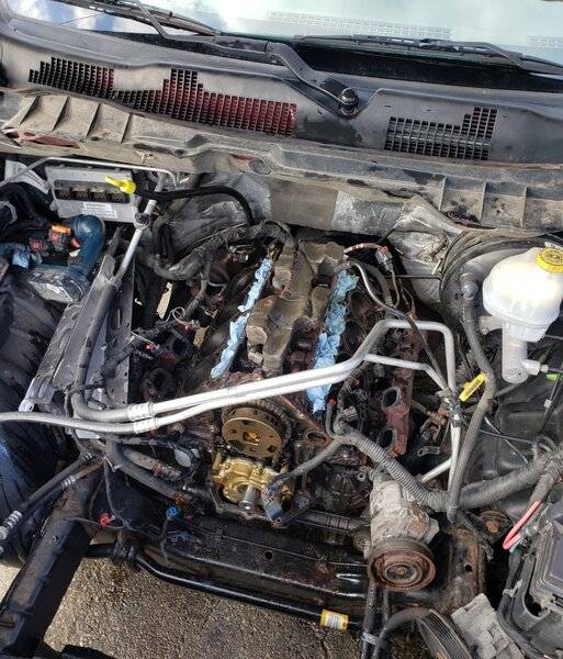

Screenshot_20210305-141438_Gallery.jpg Screenshot_20210305-141451_Gallery.jpg Screenshot_20210305-141510_Gallery.jpg Screenshot_20210305-141526_Gallery.jpg
Now you have to pull it and do a complete overhaul.

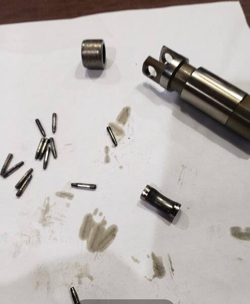

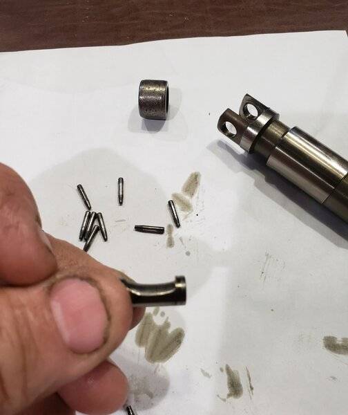

I took the worst of the lifters apart. None of the needles were broken or appeared to be worn.
The tips were blued from the heat, but they actually ate into the axle.
Maybe a hardness issue with the axles along with oiling issues.

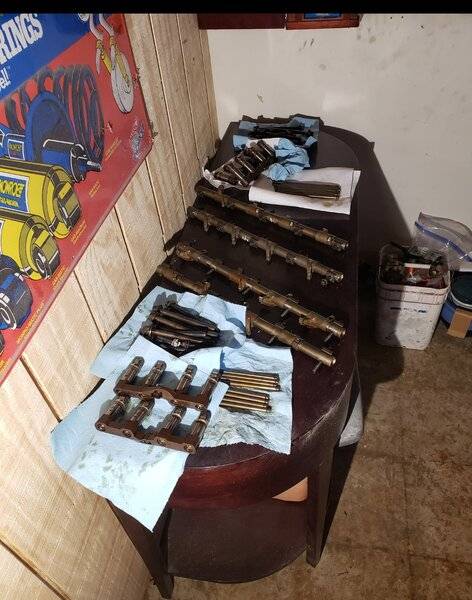

Screenshot_20210305-184704_Gallery.jpg Screenshot_20210305-184730_Gallery.jpg
Just put it all back together with new parts, you,ll get another 140.000 out of it and be done with it. Not much else you can do.
Don't you miss the old Chrysler corporation? They wouldn't have let this BS go on for years and years.
8 lobes on the camshaft had damage to them. Pitting/wear.
Only 1 lifter was bad and that destroyed the lobe.
Oiling is a large player, but this had to be a bad camshaft to begin with.
