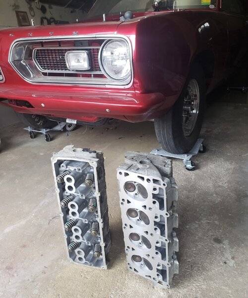

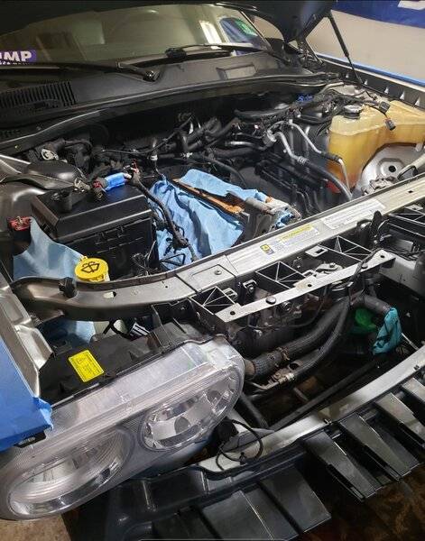

On my son's car, a 2012 6.4 Challenger, we noticed a tick.
70k miles. (Mostly abusive)
We decided to be proactive and tear into it.
All lifters were fine, but the cam had a few scuffed lobes.
It was starting there too.
Since its apart, may as well go bigger now...
Heads were redone, and another issue with these things resolved.

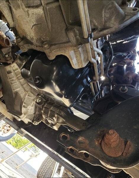

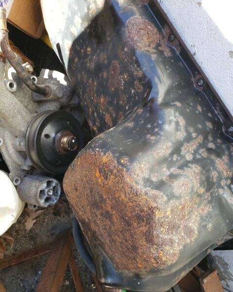

New oil pan.
Screenshot_20210318-071118_Gallery.jpg 20210318_071057.jpg Screenshot_20210318-071045_Gallery.jpg
The oil pan thing is an across the board thing, I swear they manufacture them to rust. I think they would rust in the desert....The car company's build cheap **** then sell it for a kings ransom and cry poverty as they pay themselves millions in bonus's....

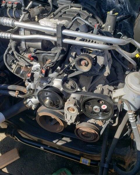

I was aware of the issues with these engines when I bought it so I was being as careful as I could with it.
Back up and running again.
Mds deleted and towing tune installed.
If I get another 100,000 towing miles I'll be happy...
