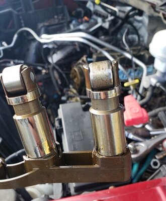

Just developed a slight tick and shut it down immediately due to the 5.7's reputation.
Another project, just what I need.
https://youtube.com/shorts/vlvwjwmTIrI
It had not yet thrown a CEL...

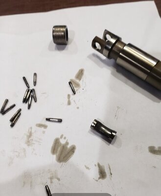

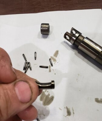

I took the worst of the lifters apart. None of the needles were broken or appeared to be worn.
The tips were blued from the heat, but they actually ate into the axle.
Maybe a hardness issue with the axles along with oiling issues.
I won't buy another until they update the block design.
