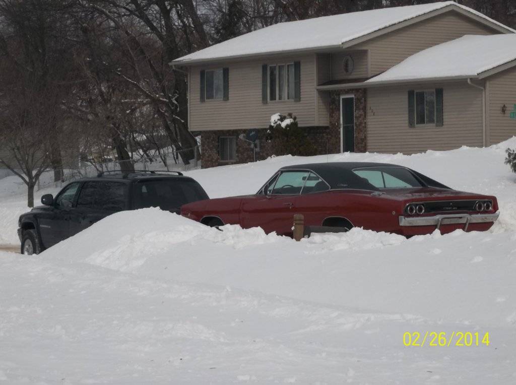

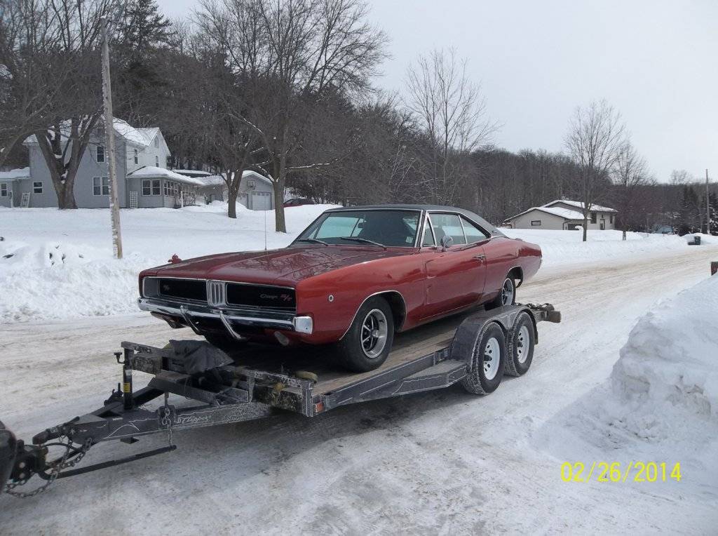

I have used my wife's 2000 Durango a quite a few times over the years with no issues. It is a 4.7 with 3:55 gears. I did make the mistake of not using the equalizer hitch once while hauling my 70 Challenger to the Mopar Nats. The short wheel base makes for a choppy ride plus driving at night you get lots of high beams from on coming traffic. Since then I always use the equalizer hitch and shut off the overdrive.
IMO you would not have a problem as long as you have trailer brakes, use an equalizer hitch. Those two things would be a must. As for the overdrive, I had a shop foreman at the local Dodge dealer tell me that if I had anything heavier than a June bug on the hitch to turn it off. The other thing I would recommend is a transmission cooler but I would have one of them on any tow vehicle.

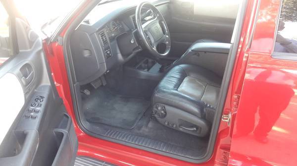

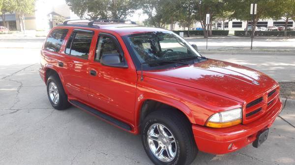

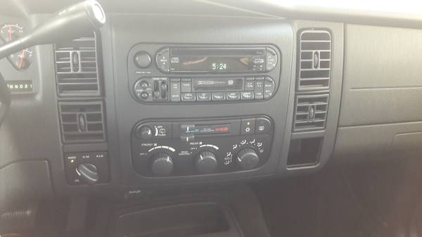

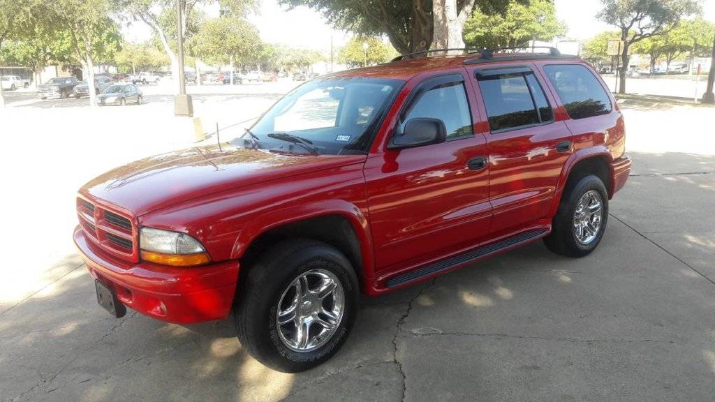

Thank you all for the replies, advice, stories! It helped me a lot in my decision to go ahead and get the Durango R/T. I would love to buy a full size pick up but they are just too expensive and I refuse to have a car payment (besides my wife's car) plus trucks are just expensive as it is. This is honestly just to nice of a vehicle for me to pass up and the price is really good. It will be even better once I sell my Buick LeSabre and I will only be out about $3000. That's not bad for a super clean low mileage AWD SUV that can tow on on occasion when I need to move the bird. When I do, I will always use a UHaul Loader with the trailer brakes so I am confident it will be okay. Shoot, this thing will probably tow better than my 2014 V6 Ram did. Horsepower was good on it but it had no torque and ran super hot. I am sure the Durango will suck gas but I can buy a lot of gas with out car payment. :)
This is what she looks like:
Nice.
Are those chrome wheels or caps?

They are chrome wheels. When I looked at the cars DIC (display info center as GM calls it :lol:) it showed him to be getting 17 mpg but I have no idea how long it had been since he changed it. My Buick only gets 24 so if that is the case, I will be happy with it. My dad's 99 5.9 Ram got about 16-17 so that sounds about right to me. I don't have a heavy foot anymore because... well because I drive a Buick. It put a huge smile on my face yesterday when I gassed it hard and heard what V8 exhaust sounded like for the first time in years.

Great looking R/T. Wasn't there a front suspension problem with some of the early Durango's, like upper control arms?
The front end issue was ball joints.
Mine doesn't have that issue either. I still have the as built parts on!
