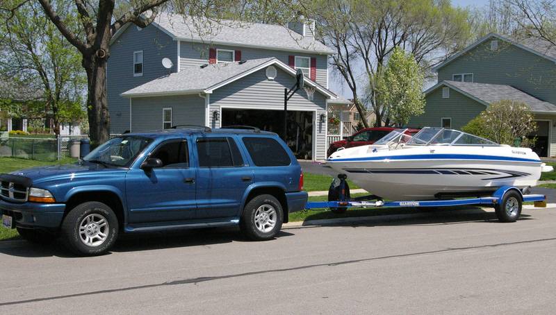

My '02 4.7 struggled just a bit to get things rolling from a stop towing my 3400 pound boat. Other than that, never had an issue. This did not have the "tow package" on it. I just bolted a hitch on and added a five-flat wiring kit. If you're going to flat tow a car or a heavy trailer without brakes, you're going to need some extra stopping room.

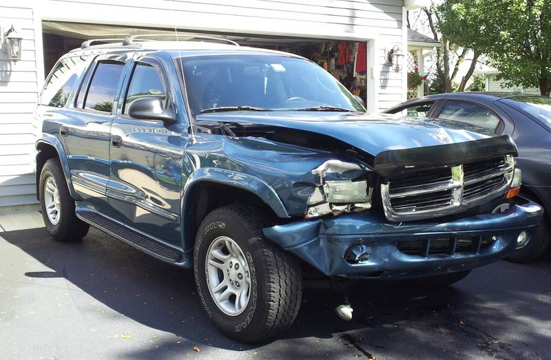

Hey, thanks. Unfortunately a guy from France going the wrong way on a one way totaled it for me in downtown Chi.............

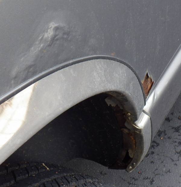

Oh Sh!t... hopefully everyone was ok. Been through similar situations. Several years ago insurance wanted to total my 02 Explorer, I persuaded them to fix it. I'm still driving it, unforunately the Michigan winters have really started taking a toll on the lower rockers the last couple years.

No air bag deployed and I banged my head on the roof and rammed my knee into the column. Wife and daughter nothing. I was more pissed than hurting at that point. A day later I started hurting.
............Hey, that's not rust, that's the northern Dodge truck trade mark showing through. Showing on my '05 Ram too.

Bought it new in '01. I added running boards and the OH trip counsel myself. Busted my azz keeping that thing clean. When totaled it had 72K on it and they valued it at 7600. The whole nose shifted about 8 inches to the drivers side, bent the frame and K-member but no air bag popped.
