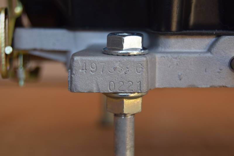

looking for a early 1000 TQ # 4847S or SA .... or a 4973s. if i recall right. the 4847S were on BB cop cars and HD trucks with federal smog and no NOX.
the 4973S was for a 340 with a auto
basically looking for the big non smog TQ.
yes i used someone here's pics ..lol

from what i understand the 4973S was a 71 only 340 auto. (72S was for the stick) some say 1000 others say 800 CFM
the only info i could find in the 1000 CFM 4847S puts it on a early 70's 440 HP. auto
depending on where ya look the info seems to be based on who ya ask. so ya. if anyone can give us a strait answer that would be cool.

The 4973 was the 71 340 auto carb and the 4847S or SA was a Competition carb NEVER on any production vehicles
Most of the early 440 truck carbs had minimal emissions ports on them, probably what you are looking for. the 6545 74-77 is good, and several others.
I looked it up to be sure:
4847 was a 1000 CFM aftermarket Competition series and never
on any production car. Big Primaries
4973S was a 71 Only 340 Automatic carb 750 CFM Carb. Small Primaries
This number car was recalled and replaced by the Dealership with 72 carbs
for drivability reasons by the factory early in their life. Although recalled they
did come originally on 71 Automatic 340 from the factory (I was wrong in my
original post as I was doing it from my elderly memory.
Well I was 1/2 right in my first post = I am old.
Both these carbs are very rare and both worth a small fortune.

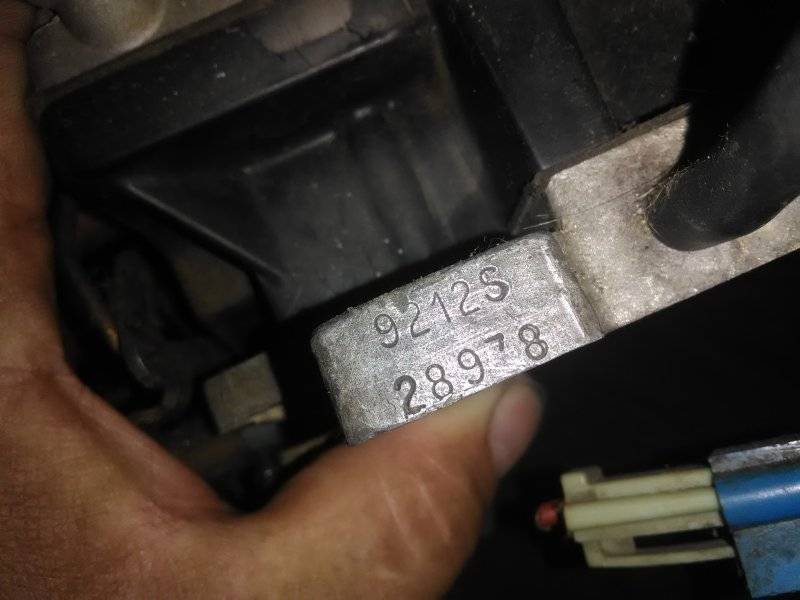

i have a 9212. a ton of smog on it. im guessing a lean burn
I cannot find a 9212 on any chart Thermoquads

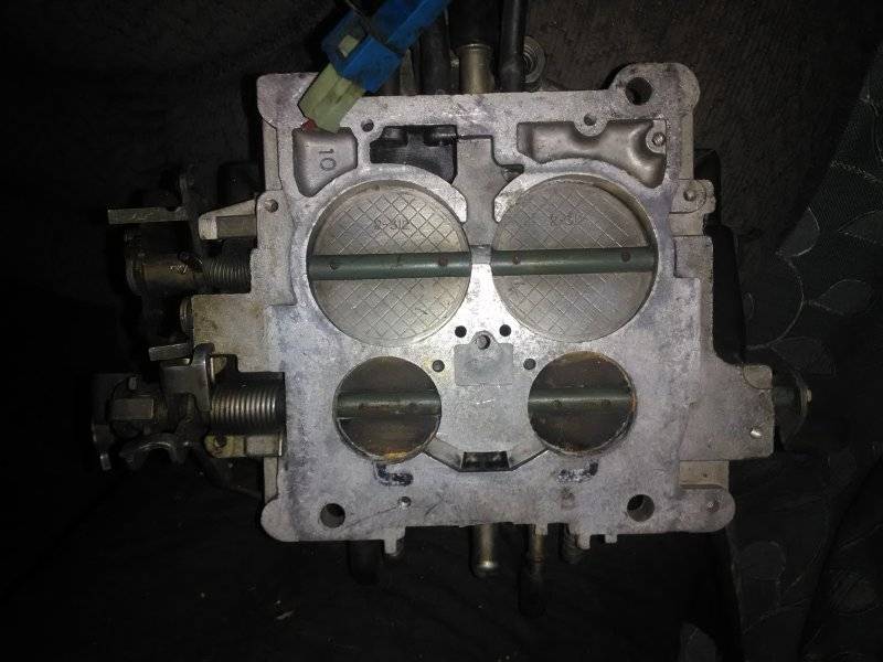

ok .. so when did thay go to all big primary's? the 9212 i have is a 600-650 one with the ring in the hole rather than the little bump. was wondering if i removed that ring. would it make any differnce?
* I Think * ‘73/4.
600-650? With a ring in the hole rather than a bump?
LOL, I have no idea what your talking about but perhaps a picture????
* I Think * ‘73/4.
