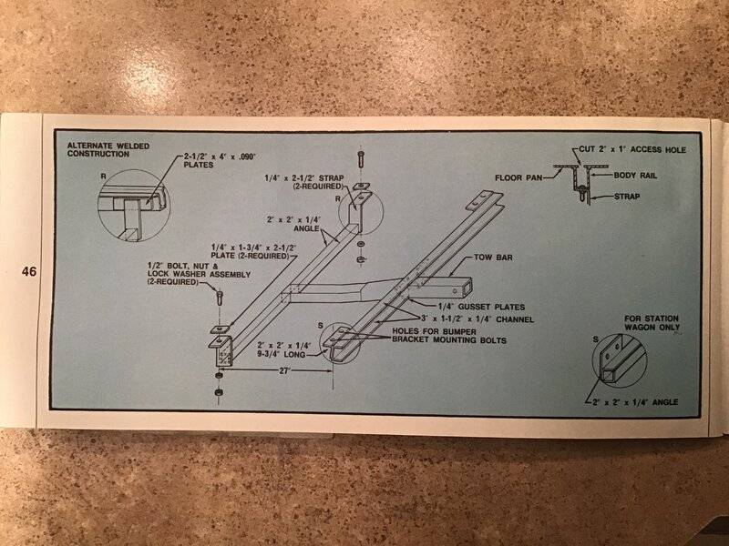

Tow package in 60’s doesn’t include a hitch or wiring. It includes a 26” radiator, 11x3 drum brakes, 3.23 gears, Sway bar on front, wider wheels, 5.5” instead of 5.0”. I had a 67 Belvedere 383 2bbl with trailer towing package on the window sticker.
The 1967 Belvedere owners manual shows a trailer hitch on page 46 and towing instructions on page 45. Does your 68 charger manual have anything like this?

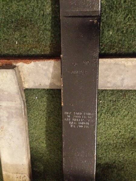

I have 2 charger hitches, one is stamped 68 charger. and the other one is not stamped.
I installed many Draw Tite brand, bolt-on hitches years ago at the dealerships I worked at.
View attachment 1134809 View attachment 1134810
