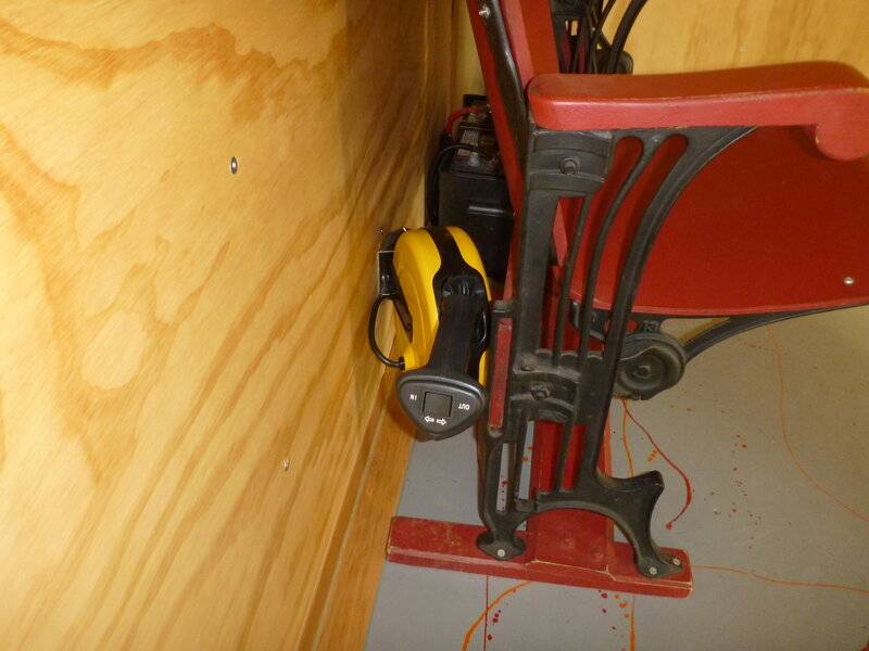

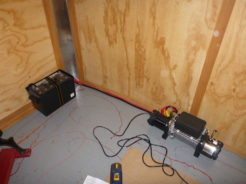

Winch will need it's own battery to operate. I added the same small isolator that the emergency brake away battery uses to get charged while the vehicle is running. On the winch I have both a remote on a retractable cord and a wireless remote, as the day I go to use the wireless I know the battery will be dead in the remote.

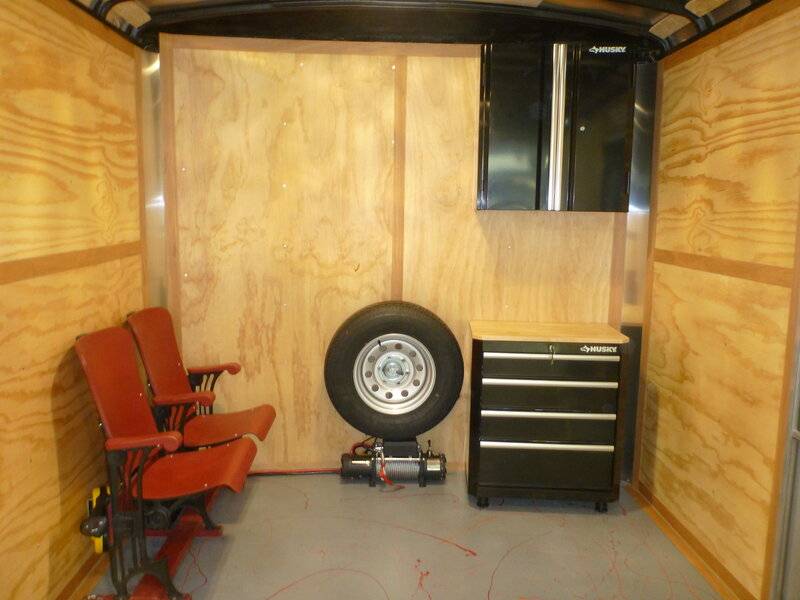

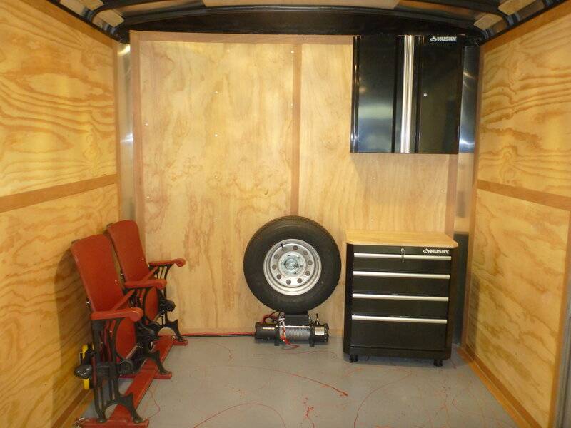

Battery recharge for the winch battery is a good tip. The trailer is going to be singular purpose for retirement and traveling to car shows with a specific car. Nothing else will be stored with it. I have considered two small doors in front to fasten down the front suspension. It will always be winched in. My parts buyer friend has recommended the synthetic rope on a 7000 lb winch.
Is your floor twin rolls of vinyl?
Floor painted with a 25 year old can of Alkyd floor paint that I had on a shop shelf. Walls Varathaned with a can that was probably as old..
