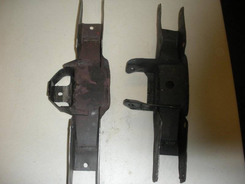

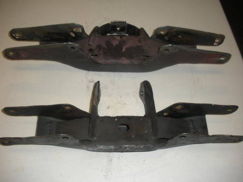

I should know this, but getting old sucks
which one for manual? and which end is front? ........ thanks
I don't think there is a difference for 1970.
The one on the left is from my 1970, an original automatic setup.
The transmission mount sits at the front of the crossmember.
got it...... attached thread is correct.......... this place rocks :thankyou:
1970 is same auto or 4speed.......66-69 bbody is different
