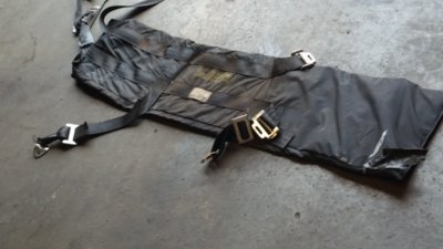

My tranny MAY run hotter with the blanket, but, I works fine (with extra heat ? )...both with my old transmission and my new A&A Tranny
I installed one on my car because you will happen upon a tech inspector at some race and he will say you cant race without it...then you gotta try to install it at the track … bummer.

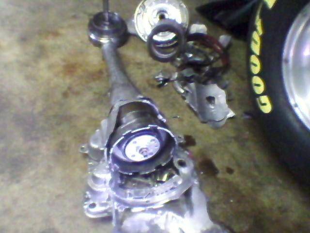

I also installed it after looking at some pictures online of the results of a bad trans explosion...pretty scary.

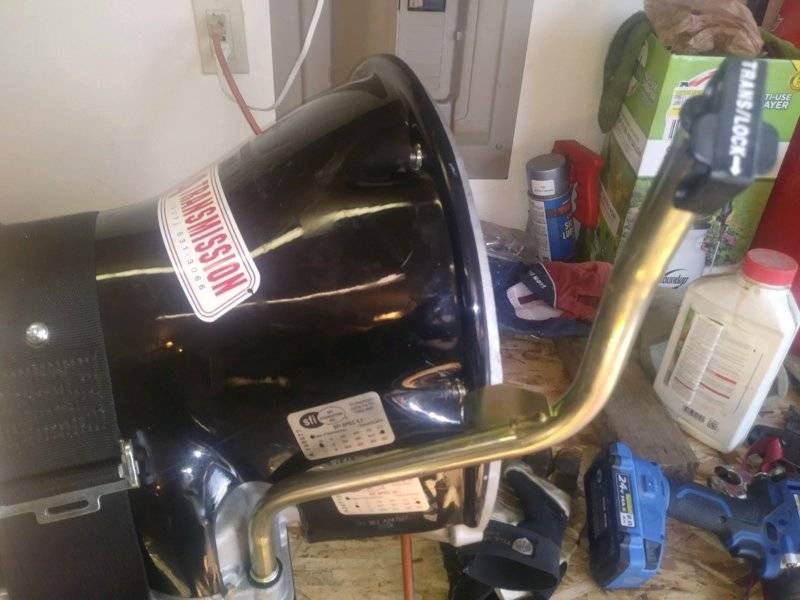

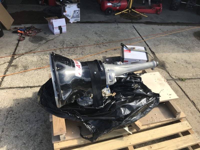

Make it fit.... Just pull the ballistic packing that is inside of the nylon bag out of the way where it needs to get past the collector and the trans pan and then just PULL IT THRU.
I had a similar problem with mine. All it did was melt the nylon bag where it touched the header. It stunk up the place for a while and I certainly couldn't sell it for new now... but... the blanket is in place.

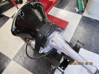

I bought some addition nylon strapping material to tighten the blanket better around the tranny.

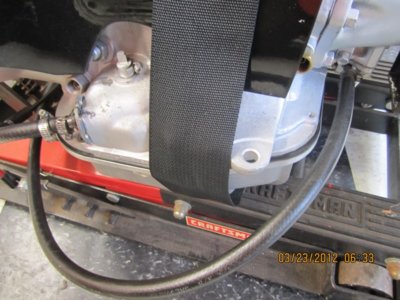

I dropped the transmission cross member so I could lower the tranny to make room for the blanket to wrap around the tranny. A heck of a lot easier that trying to pull it over the top of the trans where you have very little room. Also with the tranny lowered somewhat you can message the blanket into place easier.
I did have to kind of "re-route" the lines that came out of the tranny and then went up to the tranny cooler. I used steel braided line with some steel line to braided line adapters to accomplish the transition.
Every think works fine. Been on for about 2 years now.
Note: you can see where my blanket had been burned on the bottom right corner by my header … no big deal. I had the blanket off when I replaced my old transmission with my new A&A Trans Brake Tranny.

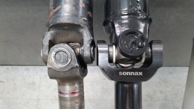

Also, If you don't have it I would install a steel billet slip yoke with the big u-joint coming out of the trans. My Dana already had a steel billet yoke in the rear.
I do not run a blanket, but have both the billet steel front drum, and the A&A Ultimate Sprag with the extra rollers.

Gary, I like Mike says, seeing the carnage left over when a torqueflite comes apart, you will be a believer. You are correct the blanket might add a little heat and they are a bastard to install but it beats the hell outta nothing. I have used the CSR composite shield for years. Just my thoughts..:blah:
