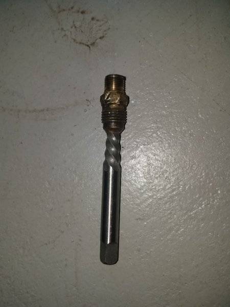

I am in the final stages of my restoration and have run into a bit of a snag... well several snags. I have a 1972 Roadrunner 340/727 with Doug Headers and my factory hard lines no longer work. That's my first issue. My first solutions was to remove all of the fittings in the transmission and radiator and replace with an-6 fittings and run braided steel line around the driver side. That is still my preferred method but that leads me to my second issue. The front brass fitting on the transmission stripped the socket area and I can not get it off now.I probably can but it will require me to drop the transmission Line threads are still good though thankfully.

Drive a "Easy out" into the fitting and unscrew it. Remember stock tubing is 5/16" and -3AN is 3/8".

Mike, thank you! I had the tool the whole time and I got it out with ease. Never even crossed my mind. I was going to use a -6AN fitting instead of the 3 since that seemed small. Do you think I should go smaller?

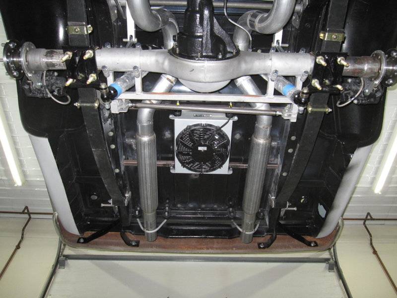

3/8" will certainly flow enough for cooling and keep costs lower. That is what I used to feed the rear, fan equipped cooler in my 65 Belvedere.
